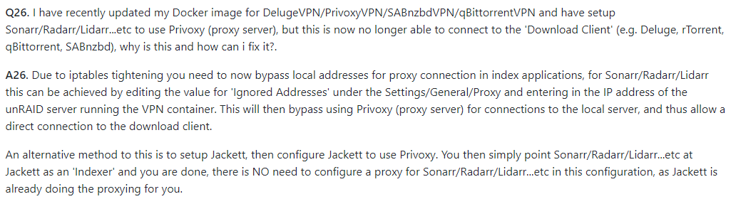

Anyway, all changes went very smoothly, no errors, no unusual entries in logs.  System felt snappier of course with 24GB RAM given I'd often be at 88-95% RAM used.  But then I started to get a ton of notifications from my *arr containers that they can't see each other.  Well, I figured I messed something up so I retraced my steps, changed everything back, but the problem persists.  I then restored my appdata to a previous config just to be safe using CA Restore, updated containers, and rebooted, but I'm still seeing the same problem.  Docker containers can't see each other.  They're still on the same subnet, still same port assignments, still using Bridge mode.  Oh, and I'm also using Binhex Deluge container with Privoxy, and even though the container starts up and I can see OpenVPN obtain an IP, privoxy doesn't see it and watchdog just blinks in an out, again, after running without a hiccup for ~2yrs.

Any thoughts on how to troubleshoot what could've happened (and why undoing my steps didn't fix this?) Everything screams routing to me but I've no idea where to really go next.
For anyone with the same issue, looks like my little maintenance timing overlapped Binhex rolling out a potentially breaking change to fix a DNS leak.  Issue solved after following his Q&A.
