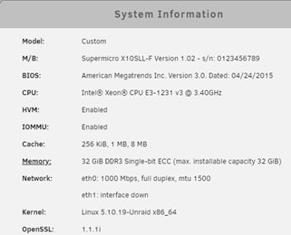

This is my HW:
I installed the GPU inside my server (after moving my SATA card to a slot with a different IOMMU so the GPU is isolated in a dedicated IOMMU).

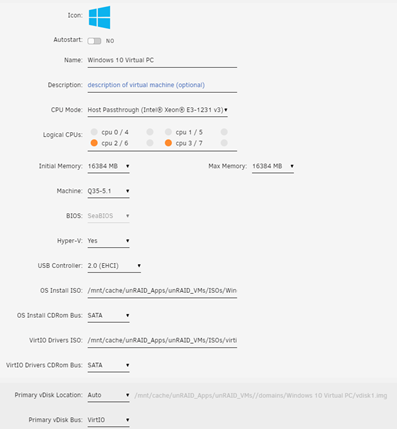

I edited the existing VM by adding the GPU as a secondary Graphics Card (after existing VNC graphics card) and the Sound/Audio Card as well (including adding the ROM BIOS from Techpowerup for the exact GPU model including FW version):

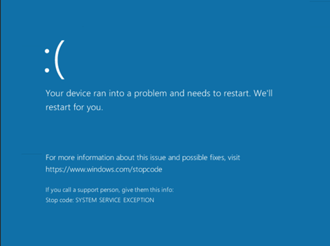

I restarted the VM and get BSOD:

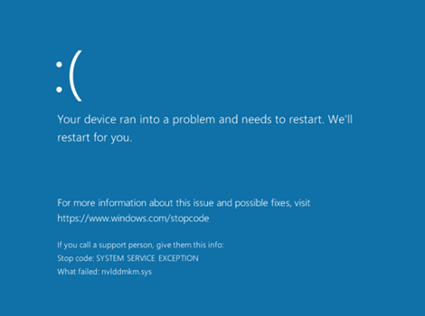

And after automatic restart – nvlddmkm.sys failure:
Windows automatically restarts again and fixes the issue (probably by reverting - removing the drivers) and again I get the Microsoft Basic Display adapter.

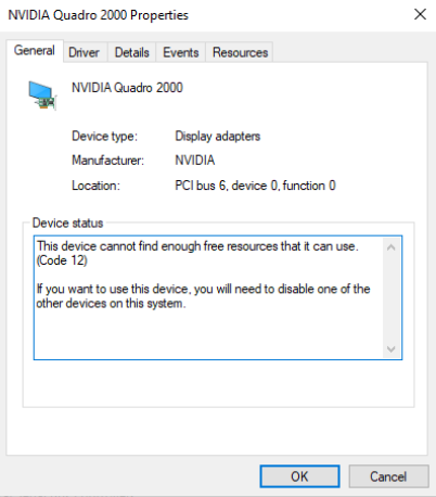

Seem to have some kind of resource conflict but can't find it:
Any other suggestions?

Have you taken the time to edit your vm xml to ensure both the video and audio nodes of your gpu are set to the same virtual bus and slot? UnRAID borks this and can cause to problems like you are experiencing.
have a look at the link in my sig for details on this and other things to try.

Try creating a new vm again but use the windows image you have already setup windows on. so don't delete the old vm image as this will save you some time.
This may help if you have not seen it already.
Also what unraid version are you using?
