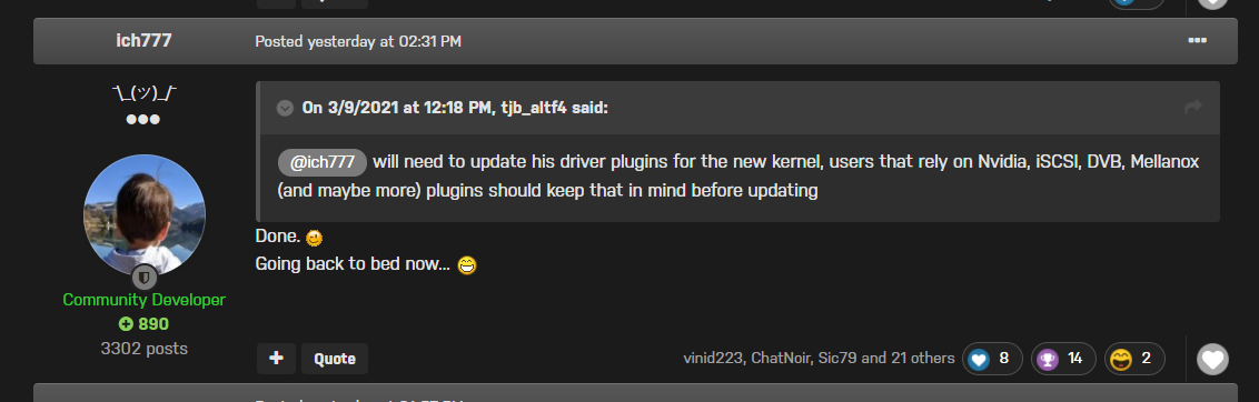

Also, couldn't get my hands on the release notes for 6.9.1  and since there is a 6.9.1 so close after the 6.9 release tells me they have a serious problem they are trying to fix. So searched again and found this:  "ich777 will need to update his driver plugins for the new kernel, users that rely on Nvidia, iSCSI, DVB, Mellanox (and maybe more) plugins should keep that in mind before updating".

it has been updated
