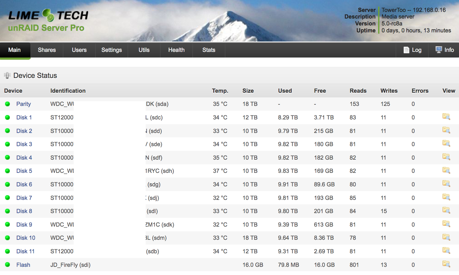

I had issues copying files to my newest drive (18TB WD Ultrastar DC HC550) and it reported as being in "read-only" mode.
I presumed it was working as I upgraded an old 10TB drive and it all seemed AOK - content seemed ok.

Issues with this are that it identifies the drive sizes wrong -
/dev/md10 is 18TB
even with creative Math for TiB and TB ..I'd still expect 16 - 17TB as listed.
