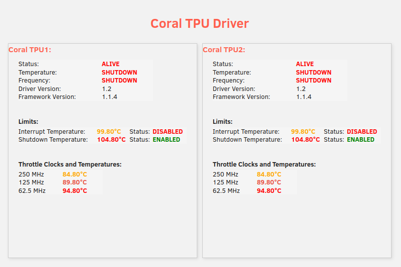

August 23, 20224 yr On 3/11/2021 at 7:03 AM, Team_Dango said: Thank you for the suggestion. I'll check for that next time I reboot the server. Where exactly did you add the pcie_aspm=off Currently trying to get my pcie google coral to work in Google's GitHub they said this I had tried disabling it my bios and that didn't help This was google's Response: can you please share how did you turn off pcie_aspm. have you added pcie_aspm=off to the /boot/extlinux/extlinux.conf? $ cat /boot/extlinux/extlinux.conf TIMEOUT 30 DEFAULT primary MENU TITLE L4T boot options LABEL primary MENU LABEL primary kernel LINUX /boot/Image INITRD /boot/initrd APPEND ${cbootargs} quiet pcie_aspm=off Thank you for your help
August 24, 20224 yr Community Expert 13 hours ago, ssjucrono said: Where exactly did you add the pcie_aspm=off Same as here: https://forums.unraid.net/topic/111161-pcie-errors/?do=findComment&comment=1013378
August 24, 20224 yr @JorgeB Thank you! I added it like so: kernel /bzimage append initrd=/bzroot pci=noaer pcie_aspm=off I will reboot and test today Thank you
August 24, 20224 yr So now it works for a bit but then my whole server stops responding. I cannot SSH webgui nothing. I have to hard reboot it by holding the power button. I also don't think I can see logs as I have to reboot so I don't get the syslog. I thought I was on the right path but I guess not.
August 24, 20224 yr syslog Ok I have attached the syslog. I really do not see anything really telling in it. Thank you @JorgeB
August 25, 20224 yr Community Expert Nothing relevant logged, PCIe errors were of course suppressed, but that might not be the problem, does the server crash without that device?
August 25, 20224 yr so the device is currently in the server and operating per the drivers it is when I start the Frigate docker that it will work for about an hour or less then crash the server. I previously didn't have a pcie bracket on it. I put one it and it started this behavior.
August 25, 20224 yr Community Expert Try a different PCI slot if available, if it's elated to the PCIe errors some slots might not show the issue, especially CPU vs PCH slots.
August 25, 20224 yr Yeah I originally had it in slot 4 and that was worse. I moved it to slot 6 currently. I had this working fine with a more generic adapter however only 1 TPU was showing due to the weird layout of m2. The Google Coral is a dual TPU m2 with an adaptor from https://github.com/magic-blue-smoke/Dual-Edge-TPU-Adapter to make it pcie

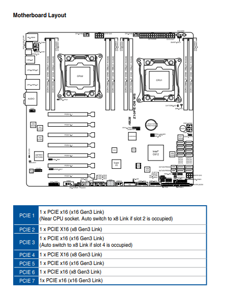

August 25, 20224 yr Community Expert Most boards have CPU slots (slots that are connected directly to the CPU) and PCH slots, slots are connected to the chipset, since that board has dual CPU it has enough lanes to use only CPU slots, the device *might* have worked better if there was a PCH slot.
August 25, 20224 yr oooh, interesting. I had no idea. I am also talking to the creator of the PCIe adaptor

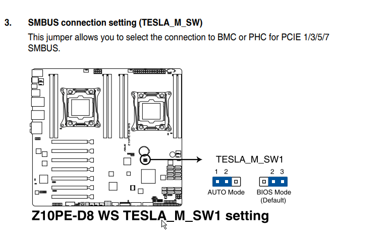

August 26, 20224 yr @JorgeB I did find this jumper on my motherboard. Not sure if that is of any help?
August 26, 20224 yr Community Expert 11 minutes ago, ssjucrono said: Not sure if that is of any help? It won't hurt to try.

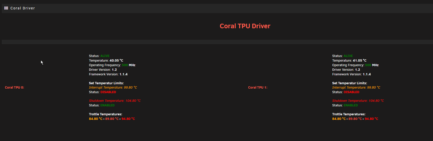

April 7, 20242 yr Hi, I have the same motherboard and coral TPU issue than @ssjucrono. Even with pcie_aspm=off my frigate will freeze after 1H or so. (nothing disabled yet on the BIOS) My coral tpu are on m2 adaptator from bluesmoke, with heatsink + active fan over it. never over 52°C If anyone have a solution, i'm desesperate everything work great with my unraid execpt the frigate stack Thanks
August 7, 20242 yr after my original post I ended up getting a refund on bluesmoke's adapter and going back to my generic pcie to m.2 adapter. Using just one of the coral TPUs. That worked fine. I did end up re-purchasing the adpater again from BlueSmoke and just installed. Again it is crashing my whole server. I am digging into it again. So, will research some more and see if I can get anywhere.
