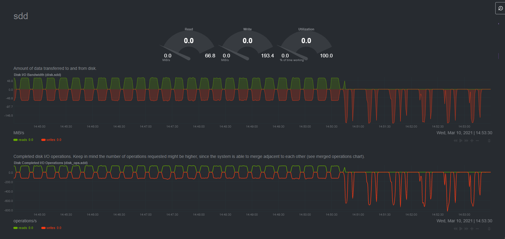

I've been able to determine that writes are actually happening at much faster speeds, but that the writes are spiking and in between nothing happens, which appears to average out to 41MB/s. The sceenshots below show the netdata docker illustrating this.

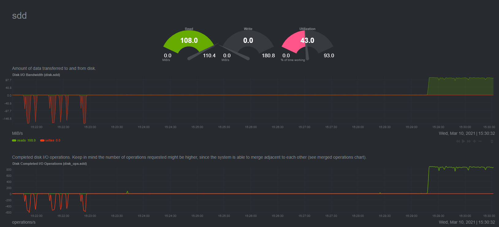

sdd: Disk1 during a write to the array. You can see where I enabled Turbo write, even though the transfer speed didn't change at all.

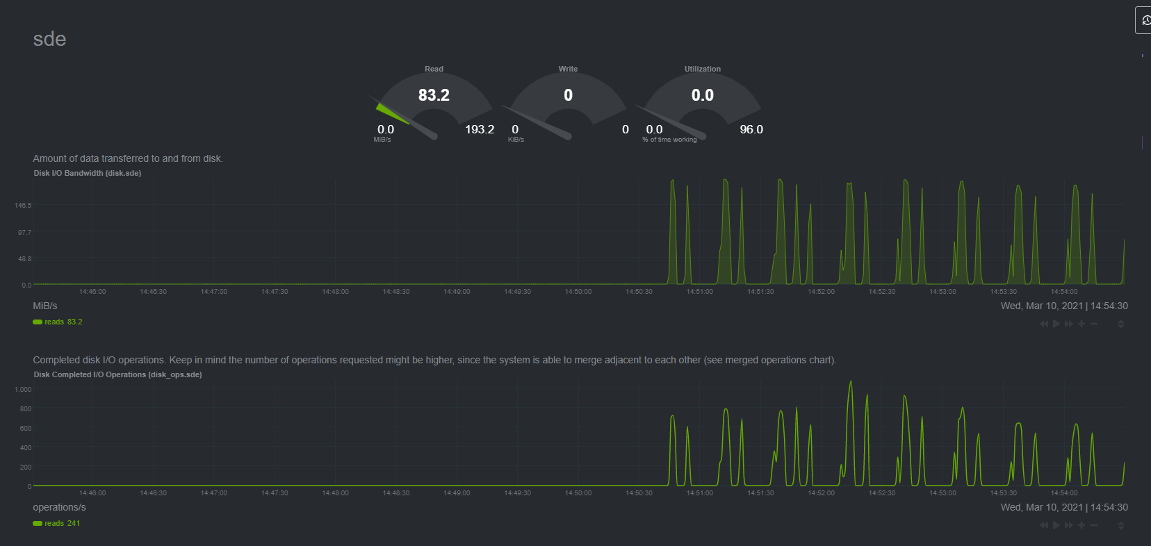

sde: Disk2, during the same time period.

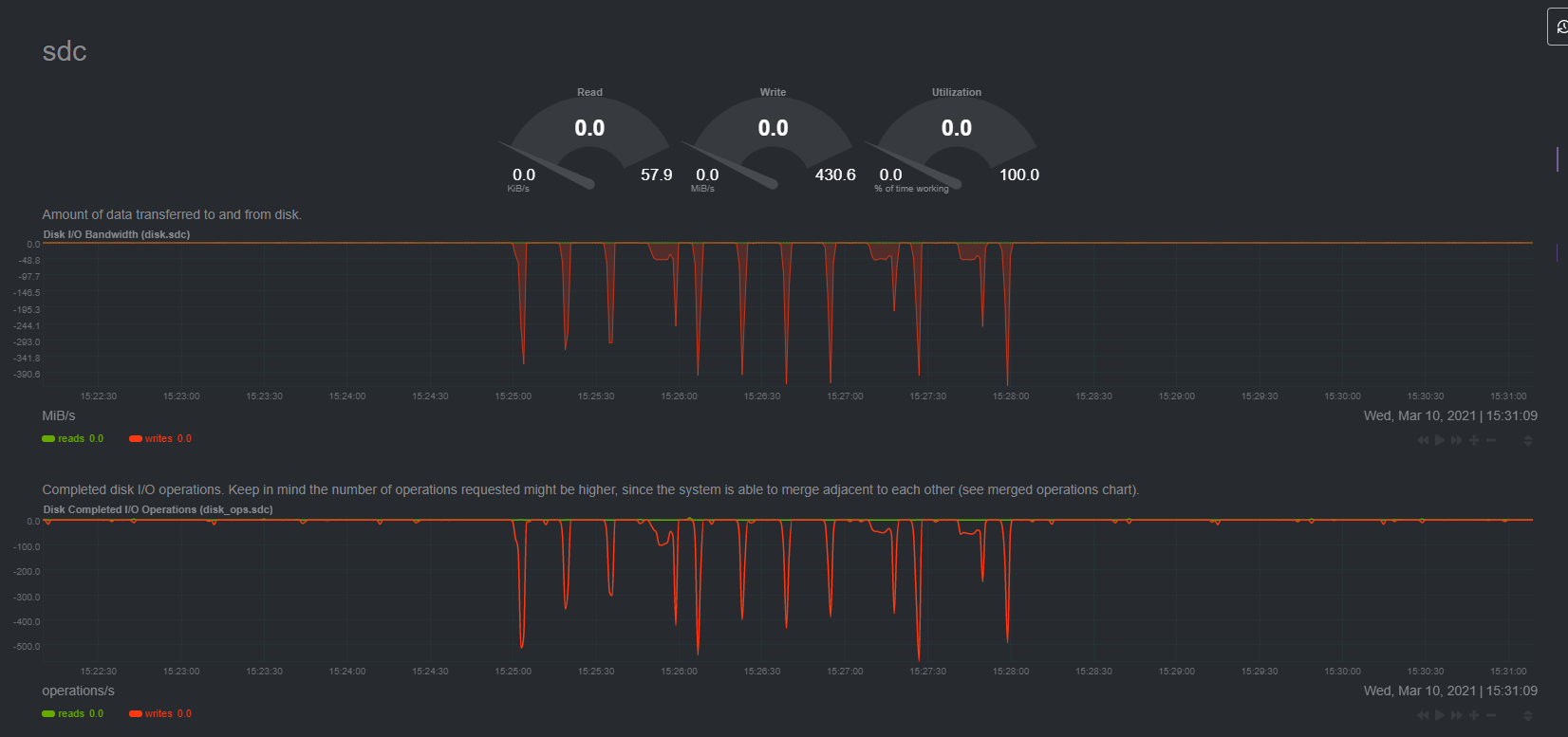

sdc: Cache, during a write to a share with the cache setting set to "Yes".

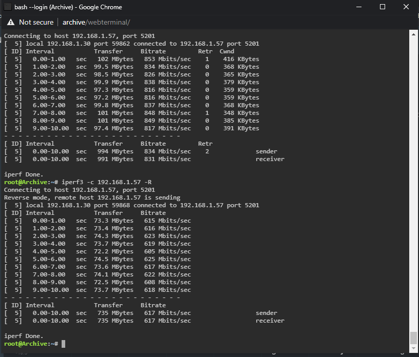

Run a single stream iperf test in both directions.
Here's the iperf result. It does appear to be slower when the server is receiving, but still not as slow as the SMB speeds I'm getting.
Edited by NinjaBreadMan
Yes, but still a clear issue, I would start with trying to fix that, try a different NIC, cable, switch, source PC, etc
