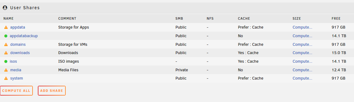

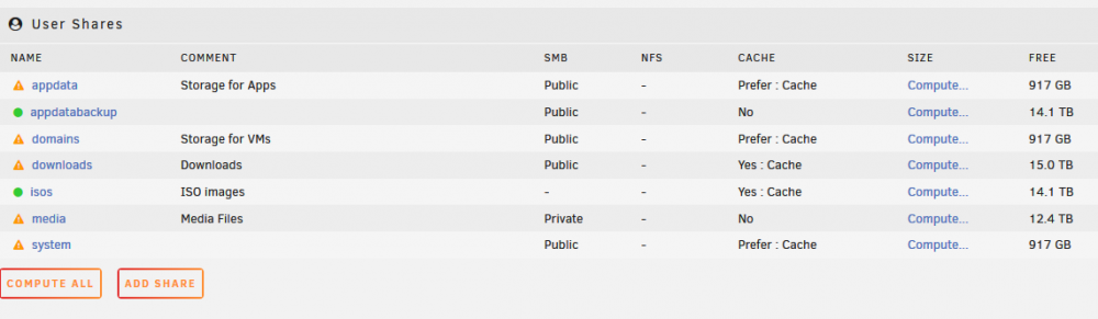

This is what I see on my shares now:
Media is the main share where I have movies tv home videos etc.
The share "user" used to be there I think... It used two separate physical disks from the rest of the shares.  It worked for so long without issue, I don't even remember how I had it set up. :)
The two disks are still there... I can still browse the physical disks and see the files.  I just can't connect by SMB, and and all my network mappings broke.
Can a share named "user" just be recreated using Disk 3,4 and it will go back to working?
I'm just perplexed as to how it just disappeared in the first place.  There seems to be config files pointing to it in diagnostics, but it seems to be gone from any unraid menu.

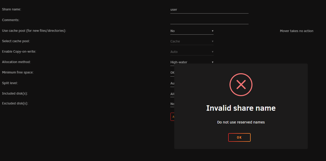

Reason is this (when I try and add a "user" share)
From the command prompt, you need to rename the share to some else:
cd /mnt/user
mv user my_users

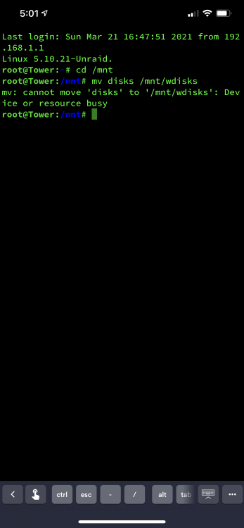

@Squid when I try to rename my “disks” share that I made a while back I’m getting
“resources in use” error do you know how I can stop the “resources” so I can get it renamed.
/mnt/disks is anything you've mounted via Unassigned Devices, and is perfectly fine.  We're talking about stuff within /mnt/user
Ok so unnasigned is excempt got it I got the warning in common problems but it doesn’t apply since it’s an unnasigned share.
FCP is only checking for whats in /mnt/user, so you've got a share in there that's disallowed
