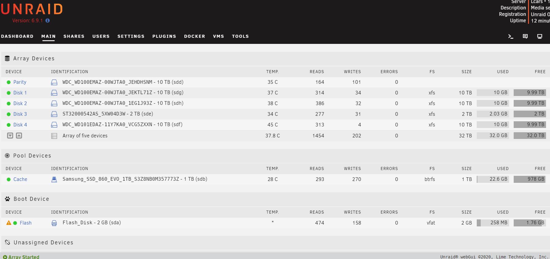

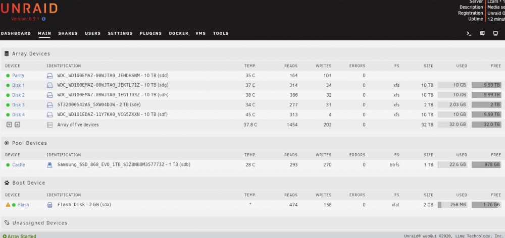

I shut it down as soon as it didn't come up with my data. Should I restart in safe mode or anything to get to diagnostics? Can I get there without starting the array? From the GUI it just looks like a new server since it's a new flash drive. All the hard drives say completely empty.
If you mean data disks mounted but they are empty it wasn't just a flash drive problem, but you can start the array and grab diags, it won't cause any more damage.

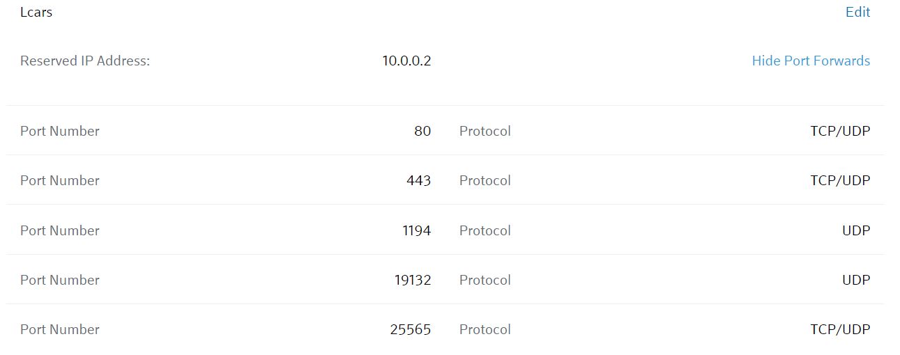

I woke up and server was down. I tried to restart and got "nothing to boot" error. Found the usb with no power complete dead. Created new usb and recovered my key and started the array with all the disks in the right spots, and all the disks were empty.  Will get the diags up here later today. I did have ports forwarded before the crash.
Which ports and why?
I don't remember why for all but one is a Minecraft server
80 and 443 are the ports to the webUI of your server. Why would you put those on the internet???
Maybe somebody formatted your disks for you.
Close all your ports before attempting to do anything else.
