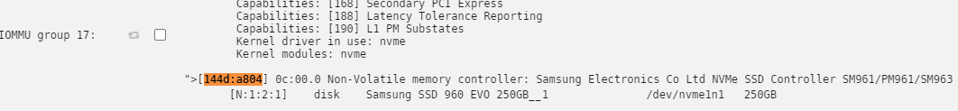

Thanks JorgeB!  Based off this, looks like the affected device should be the 960 Evo I have installed.   This is a device I am not using presently so this should be nbd, I will get this removed and continue to watch the log on this machine!

That link is broken - what did you do to figure out it was the 960 Evo? I am seeing a freeze following an RxError as well, my logs look a lot like yours before the freeze.
