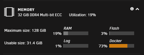

I've been trying to track down my docker image usage.
I haven't found much in the way of rhyme/reason on how it's getting larger.  Seems to be about 3% at a time though.
  • System Version: 6.9.1

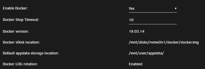

  • Docker Information:
  • Docker Settings:

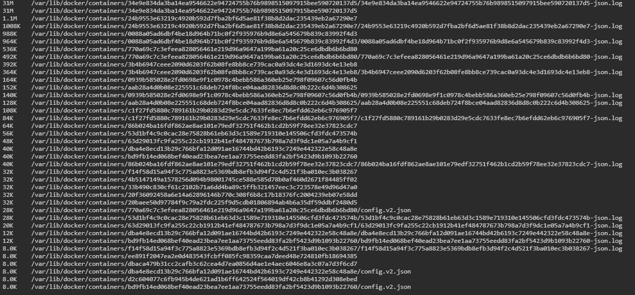

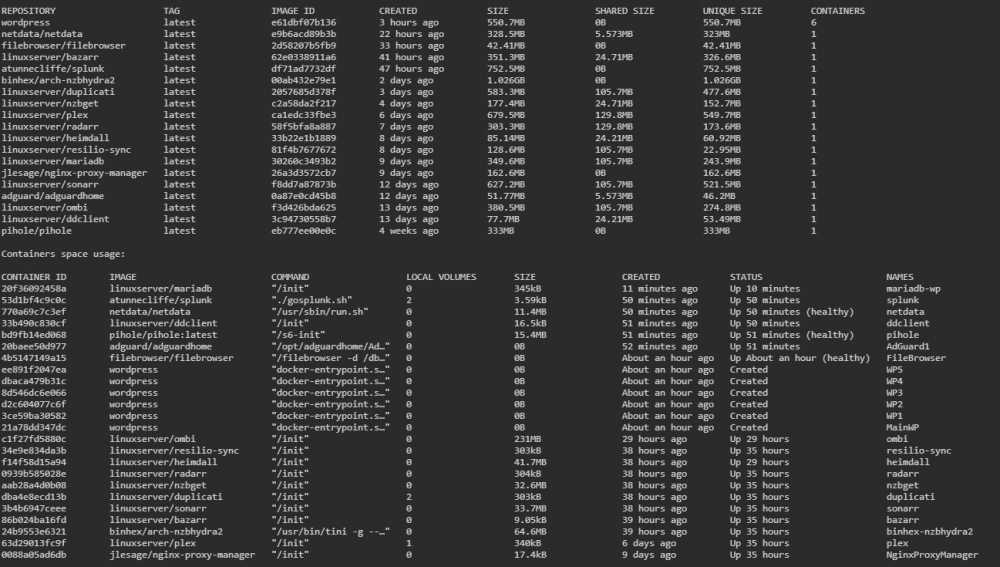

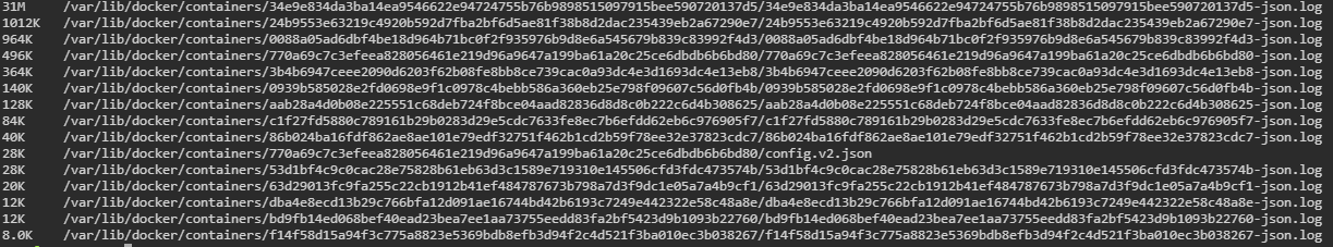

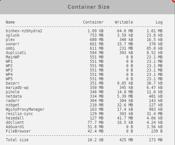

  • Container size output:
  • Output of command

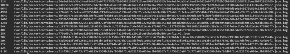

    du -ah /var/lib/docker/containers/ | grep -v "/$" | sort -rh | head -60
  •  Output of command
    find /var/lib/docker/containers/ -type f -exec du -Sh {} + | sort -rh | head -n 15

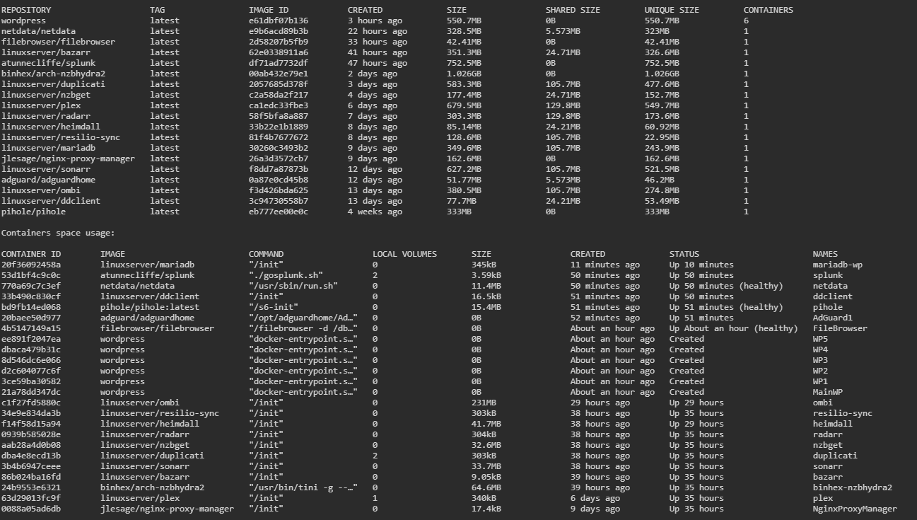

  •  Output of command
    docker system df -v

You probably have a bad mapping somewhere and one of the containers is storing files internally instead of externally. You could try looking at the docker run command for each container.
I've gone through all my mappings and they seem correct.  They all are defined based on the template, docker run shows the prefixed "/"

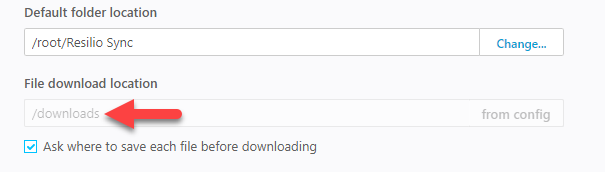

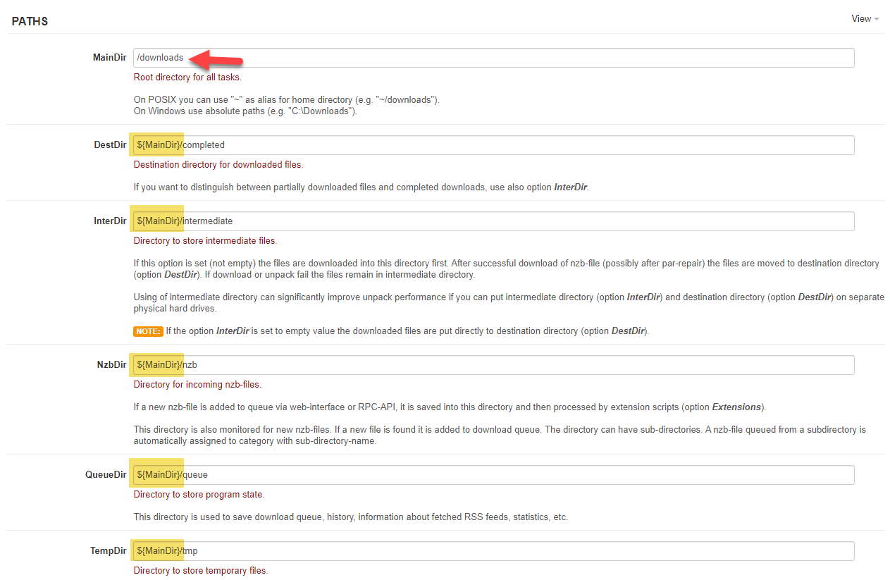

Have you matched what's in the mappings to the internal configuration of each app? If the app is set to write to /Downloads and the mapping is /downloads you will end up writing to /Downloads inside the docker image.
NZBGet is the only application that downloads anything.  It's been working fine over over a year.
Anytime I select a path, I choose it through the drop down so anything case-sensitive is preserved.
Reslio is another App that pulls data in occasionally:
image.png.0f262251c75d55bfe66069f2b2bda935.pngimage.thumb.png.4052e789dbffa580089d6a2d9ef7375d.png

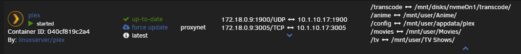

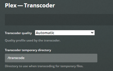

Plex (mostly default settings)

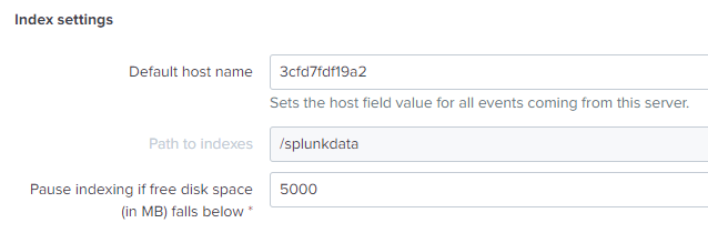

Splunk:

I did some considerable digging.  It ended up being the "splunk" container.
This was determined by doing a "force upgrade" and seeing the behavior after a restart.  The docker image usage spiked every time that action was performed.
After that, I shutdown docker, deleted the vdisk, and recreated (as XFS since this was a good opportunity to move off BTRFS) and re-imported my templates (except Splunk).
The usage has been exemplary now.
Thank you to everyone who offered support.
