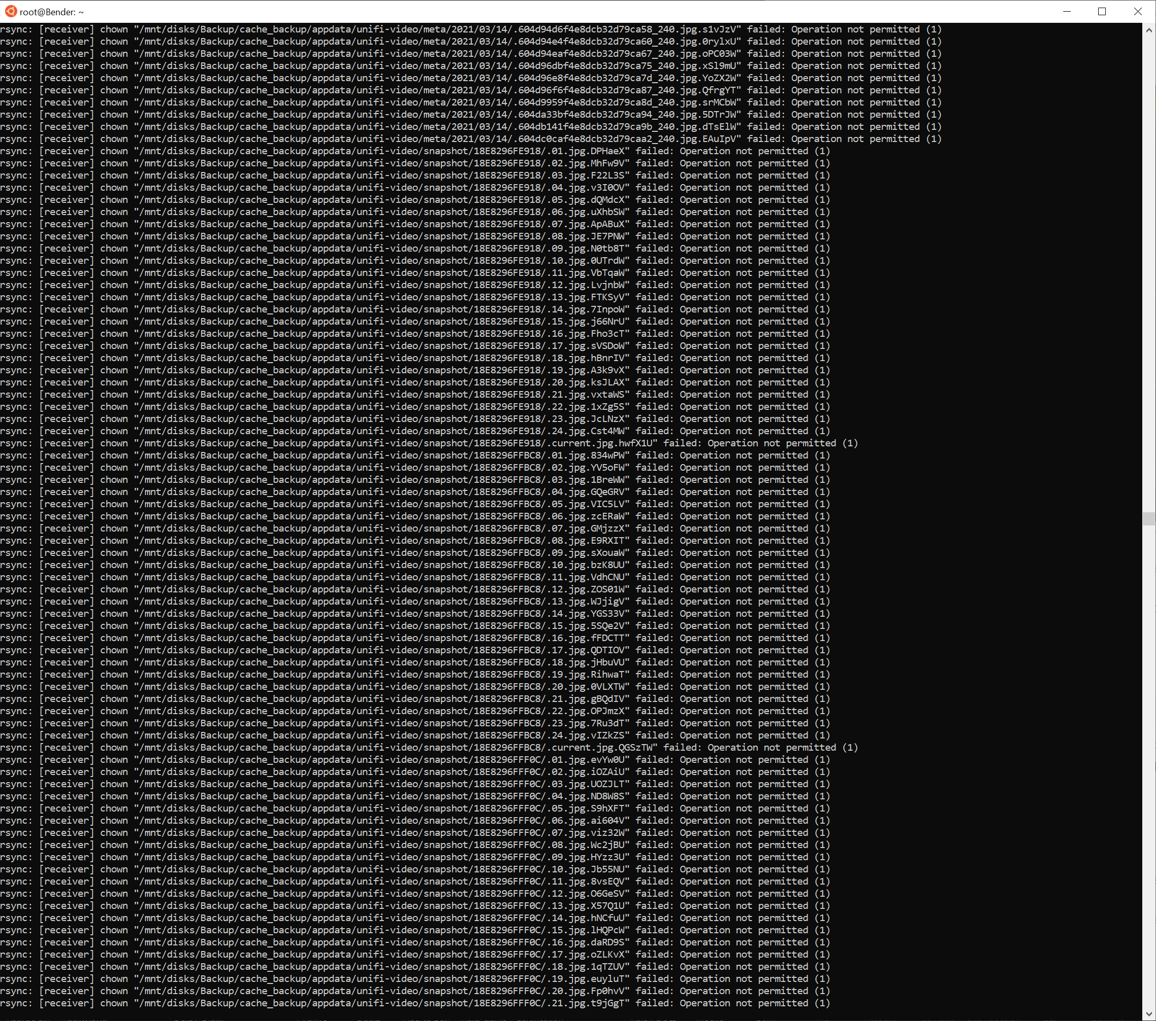

Rsync appears to have made a backup of cache pool to my backup location, but it had "chown" failures the entire time - nearly every file.
Is that an issue? I suspect it will cause grief on the next rsync operation, but I'm not positive.
That suggest the destination filesystem doesn't support permissions, e.g. exFAT
