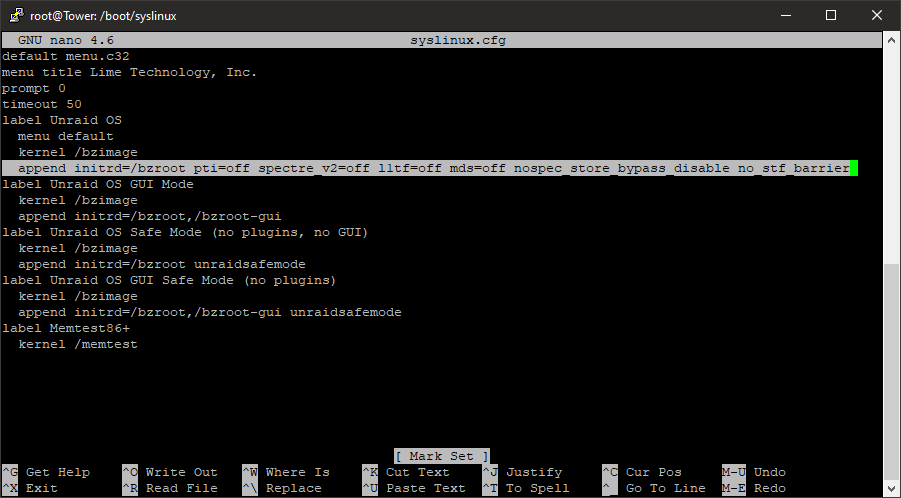

I'm about to tell you how to edit your kernel parameters, which requires messing with your boot configuration. Don't do this unless you REALLY get it. Back up your files first anyway, because if you mess this up it won't boot. You've been warned.

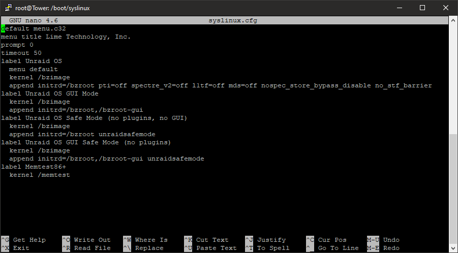

Open up /boot/syslinux/syslinux.cfg with the knowledge that you're safe because you have a backup. I use nano over ssh, ie nano /boot/syslinux/syslinux.cfg or equivalent, you know the deal.
Find your boot parameters. Here's mine, YMMV.;
You'll note I have security mitigations disabled, and that this has "no performance impact(tm)" on most hardware and that it's generally a stupid idea. Just as an example.

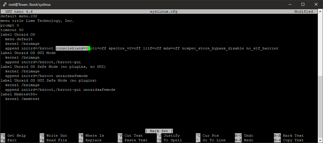

What you want to do, is carefully add the entry consoleblank=0 anywhere after initrd=/bzroot with a space around it. No run-on words. Save, exit. In Nano that's Ctrl+X followed by Y and Enter.
Reboot, and it shouldn't blank or break. If it did, thankfully you have that backup.

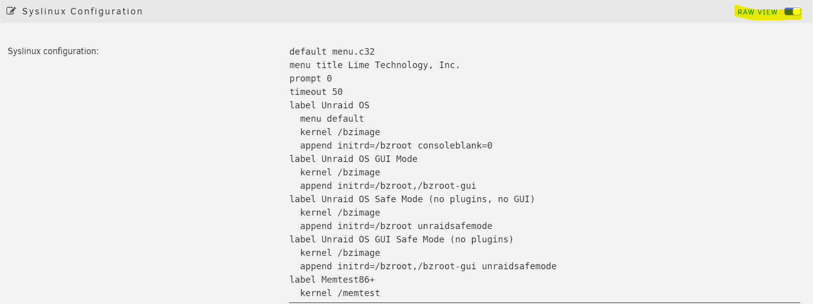

FYI you can easily edit the syslinux configuration by clicking on the flash drive in main (raw view must be selected on the top right):
Correct, I keep forgetting that because I honestly prefer the terminal. I'll try to remember to offer that in the future.

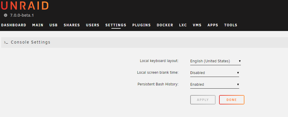

Looks like their will be a webUI setting in version 7 for this:
