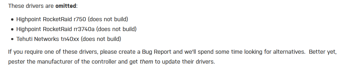

10GbE NIC driver is crashing, I believe there's a known issue with those NICs and v6.9.x
So, is this actually being worked on? I.e. can I expect a fix within, say, a couple of days, or should I seek a more semi-permanent workaround? Like a downgrade? And how does that work?
And if a downgrade is too tricky, what then can I do to get my server up & running again? I mean it's good to know that it's crashing, I guess, but that's only an explanation of why my problem occurs. It's not yet a solution. It also doesn't explain (to me) why my onboard NIC does show up as eth0, but isn't working.
From the release notes:
Yeah I saw that as well, a bit after doing the upgrade.
I'm sad that the upgrade didn't warn me for this. The installation knows it's using which drivers, and it knows which drivers are no longer going to work. It could've issued a warning.
Anyway, long story short, I haven't yet gotten an answer to the question about downgrading.
That's what the release notes are for, you should always read them before updating.
To downgrade just unzip all the bz* files from v6.8.3 overwriting existing ones.
I'll try that, thanks.
