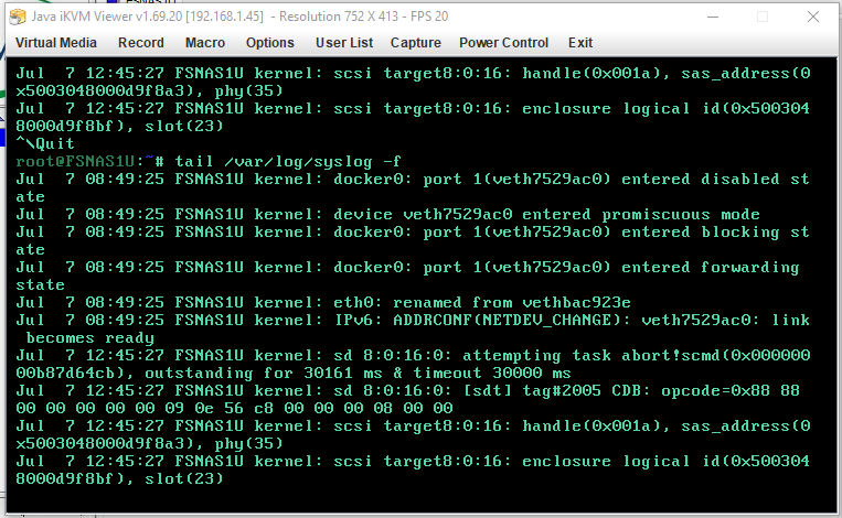

If you want to try and gather more information on what is causing this issue, you'll need to connect a monitor and keyboard to the system's onboard graphics and boot into console mode.  Login to the console with your root account and then type the following command:
tail /var/log/syslog -f
This will begin printing log events directly to your monitor.  Now recreate the VM crashing issue and I bet you'll see some critical information posted to the screen that you can then take a picture of and post back here for us to analyze.

I have IPMI on the server so I can view the console and run that command to see what happens if I can get it to crash.

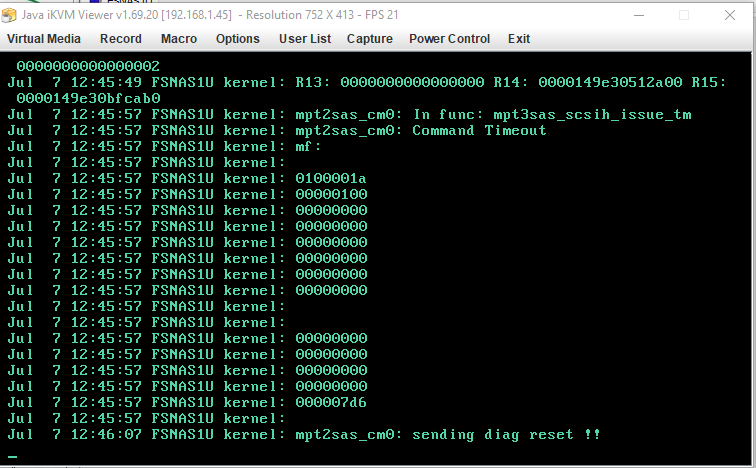

It happened again.  Any thoughts?
That device is a Mellanox ConnectX-2.  I have a ConnectX-3 as well that's not being used so I swapped them out.

It's still broken.  It's totally killed the server twice now when rebooting the VM.
How can I get the Syslog file when I can't even get IPMI to respond and it's not on the Flash drive anywhere?
IPMI console viewer lets me enter root for the user and then locks up.  All drive activity ceases on the server.  It's just dead....
