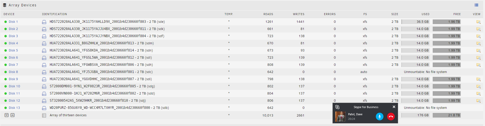

So I followed the instructions to see which of my drives should have been the parities. Are you saying that I can assign either of the unmounted drives as either Parity or Parity 1 without any data loss? See attached screenshot and let me know if what I'm saying sounds correct.
What data are you expecting to see? From that screenshot it appears that your drives are basically empty.

Honestly, I don't know. Before the crash I had 17TB of data in my raid with dual parity. One day, I got a "ldlinux.c32 not found unraid" which I think was from a random power outage. I turned off the server unplugged the USB and plugged it into my computer. The USB was blank and had nothing on it. I have no backup of the drive or config. My drives are pass through drives setup on Hardware RAID using an Areca 1280ML. I figured I could format the USB and then do a fresh install.

The other drives were already mounted before in your screenshot and that is how we could see they were empty. Assigning parity disks can't change that.
