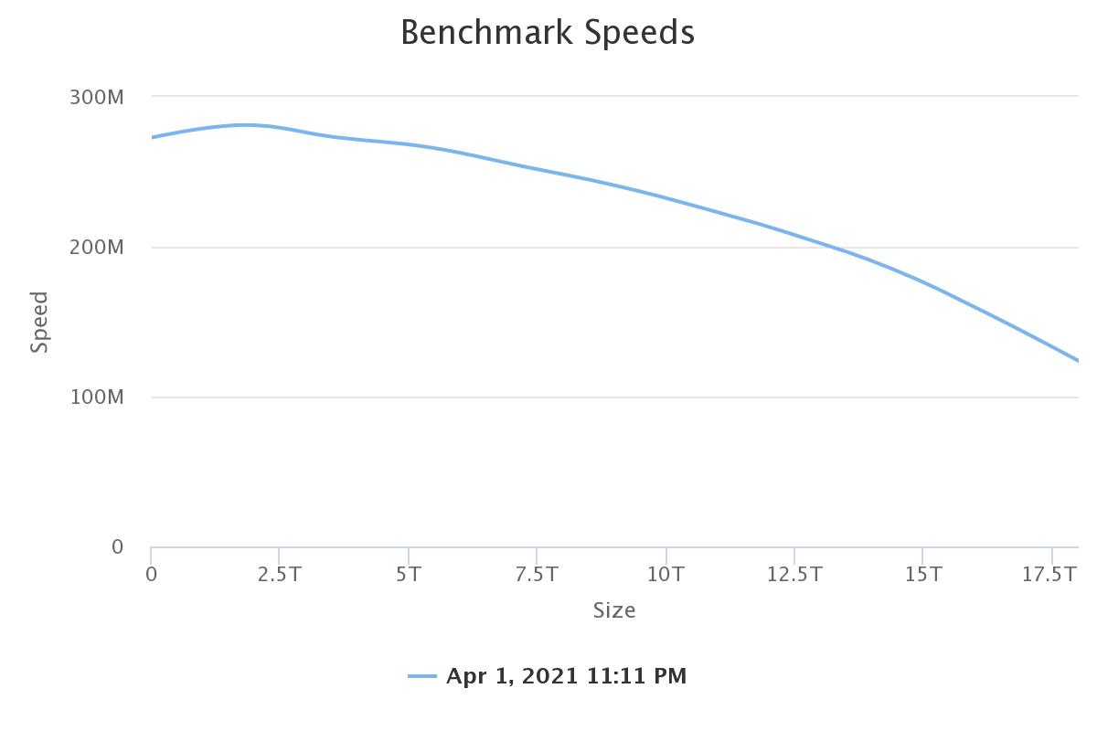

18TB Ultrastar HDD for data Disk 1WDC_WUH721818ALE6L4
920GB cache SAMSUNG_MZ1LB960HAJQ-00007 - 960 GB (nvme0n1)
I have one SMB share with cache disabled (same problem for cache-iso folder).
When I write to it (one, big file) I expect 113MBps, I have 50MBps. When I read, I expect 113MBPs and I have... 6.5MBps.

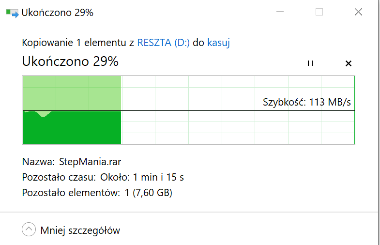

Windows SMB write speed (not under unRAID, did W10P test install😞

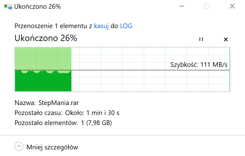

W10P SMB read:

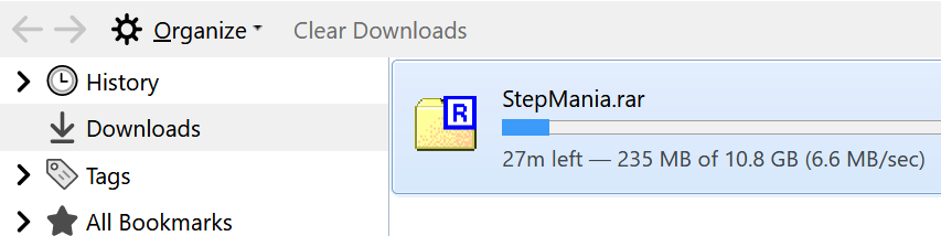

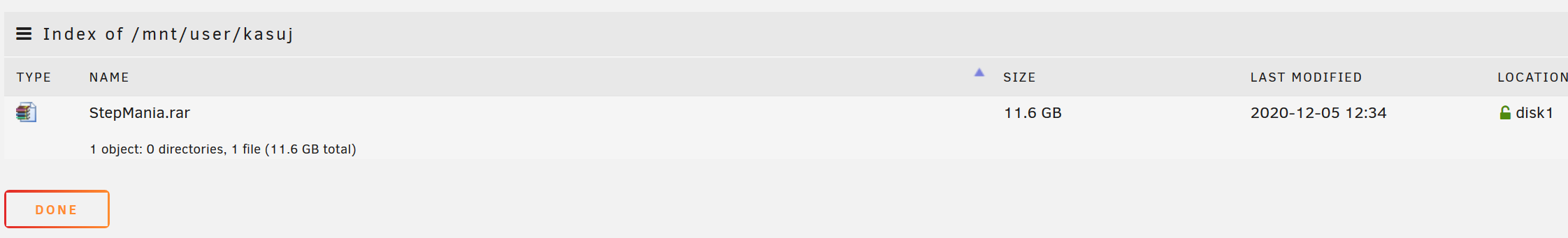

http://10.10.10.5/Shares/Browse?dir=/mnt/user/kasuj
Firefox download:
