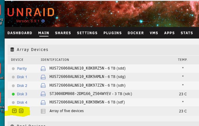

Main tab.  Green dot is spun up, grey is spun down.  Spun up drive will also show the disk temp.
Click on the dot to spin up/down that disk.  Click on the arrows below, to spin all up/down.
Ok. I tested it.
But something weird is happening.
I spun down everything and of corse everything came on again.
So I shut down most of the dockers, all that use share on array. Drive are spin up the same.
So I stopped ALL containers and VM (that should use appdata only) . Nothing changed. Drive become green again.
So I disable VM and Docker via settings. Drive becomes up again!
