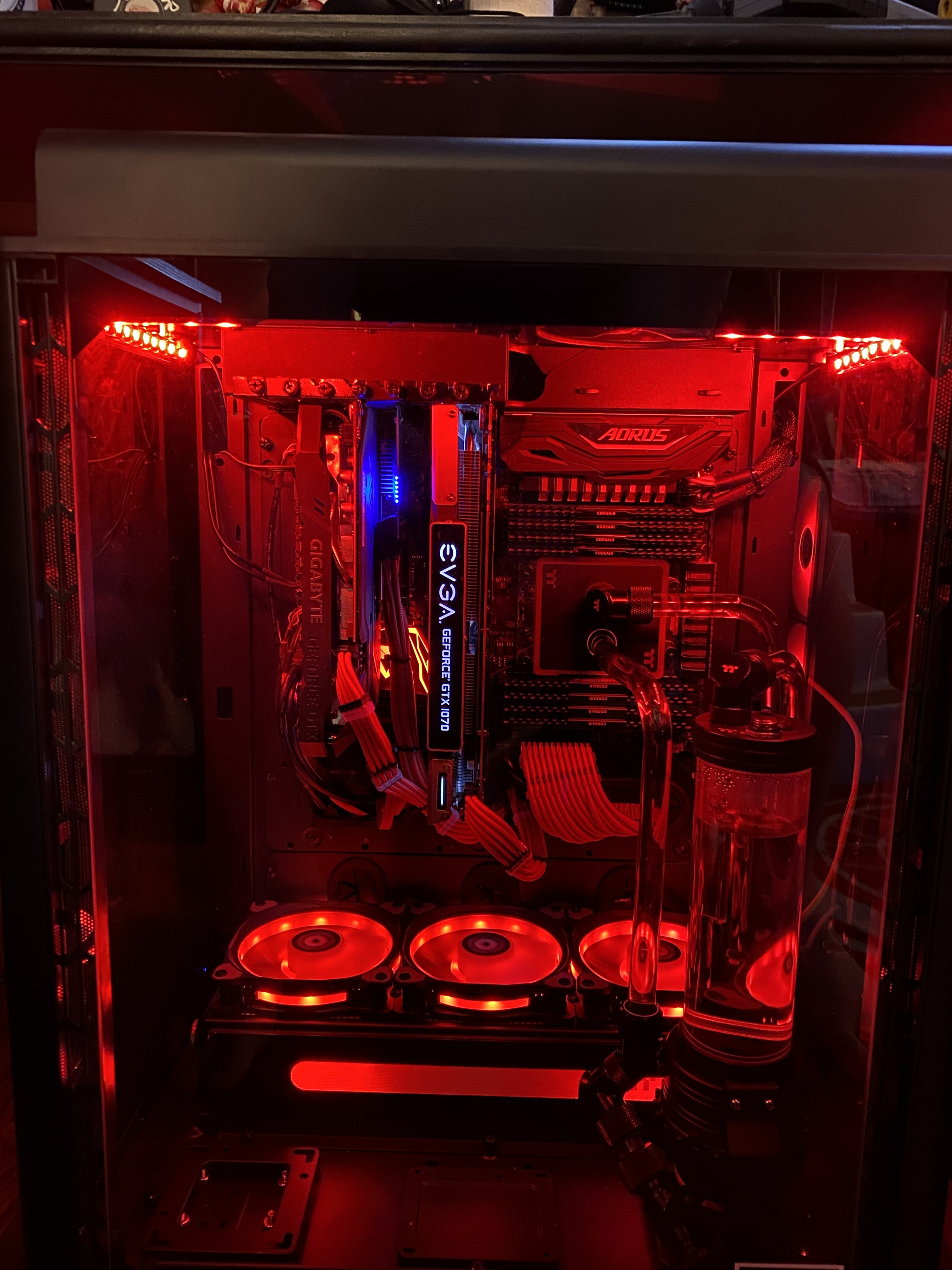

I found the reason for the shutdowns.  My cpu cooler has failed and my cpu os overheating.  I brought the PC up in the bios, after about 10 min it shut down.  I noticed the cpu temp was 93 c.
OK, that would explain it! Replacing the cooler is now the priority. Your diagnostics from 0713 look much cleaner.
John_M,  Thanks for the help, all my problems were linked to the failing CPU cooler.  I had to wait on parts but I went all in on water cooling kit and now I'm averaging 37 C and all is running fine. 🤪
