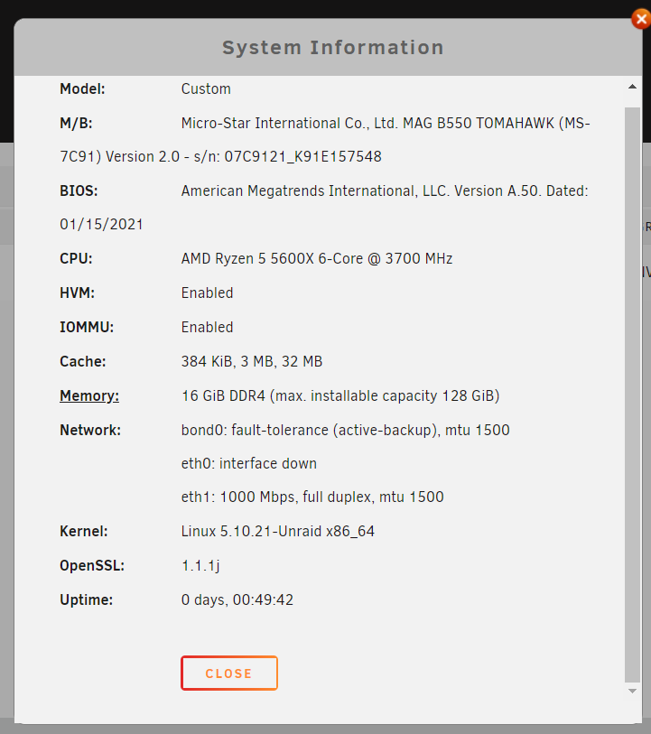

Hey how's it going? I'm actually having the same problem. I've got a very similar set up and when starting my vm the server either crashes or the vm starts but i get no HDMI signal output on my monitor.
Motherboard: MSI Tomahawk b550 (MS-7c91) Version 2.
CPU: AMD Ryzen 5600x 6-core.
GPU: Nvidia GeForce GTX 650 ti.
RAM: 16gb DDR4 3200mhz.
Latest Bios Installed!
IOMMU groups enabled in bios as well as VM's
(Attached System Information within Unraid)
