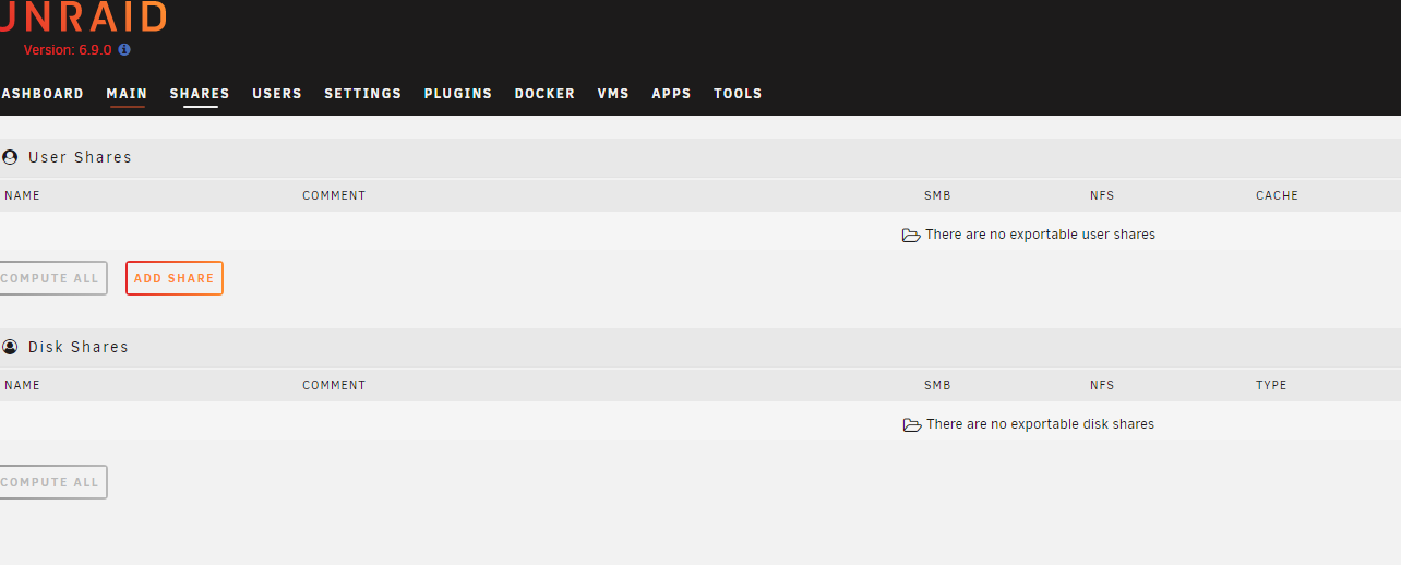

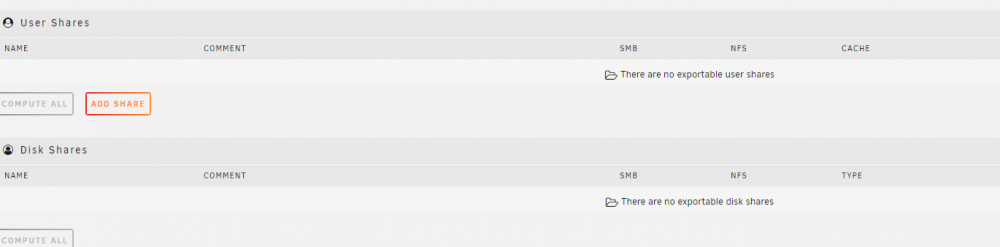

Then this afternoon my docker service crashed, when all my shares disappeared.
My docker service has been crashing fairly regularly since installing 6.9.0

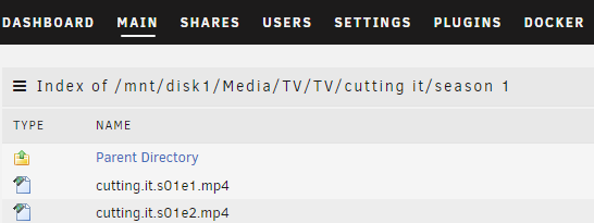

Browsing the disks the folders are there with data in but the shares are missing
But because the shares are missing all access to these files has stopped.

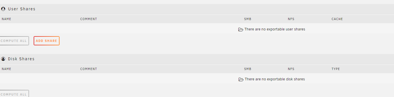

this error still shows
Apr 15 16:45:12 35Highfield shfs: shfs: ../lib/fuse.c:1451: unlink_node: Assertion `node->nlookup > 1' failed.
what do i do now?
Try rebooting again, if it keeps happening post on the linked thread, it might help LT get to the bottom of the problem if it's easily repeatable.
