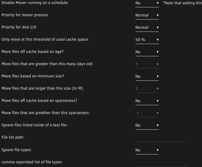

I am having a small problem My cache drive will not move the contents I included the diagnostic report to make it easer for people with more experience then me to help figure out what needs fixed.
At current I have updated the
CA Mover Tuning to version 2021.04.16 as seen in the pic.
that I read in 1 of the other posts about cache problems. no help

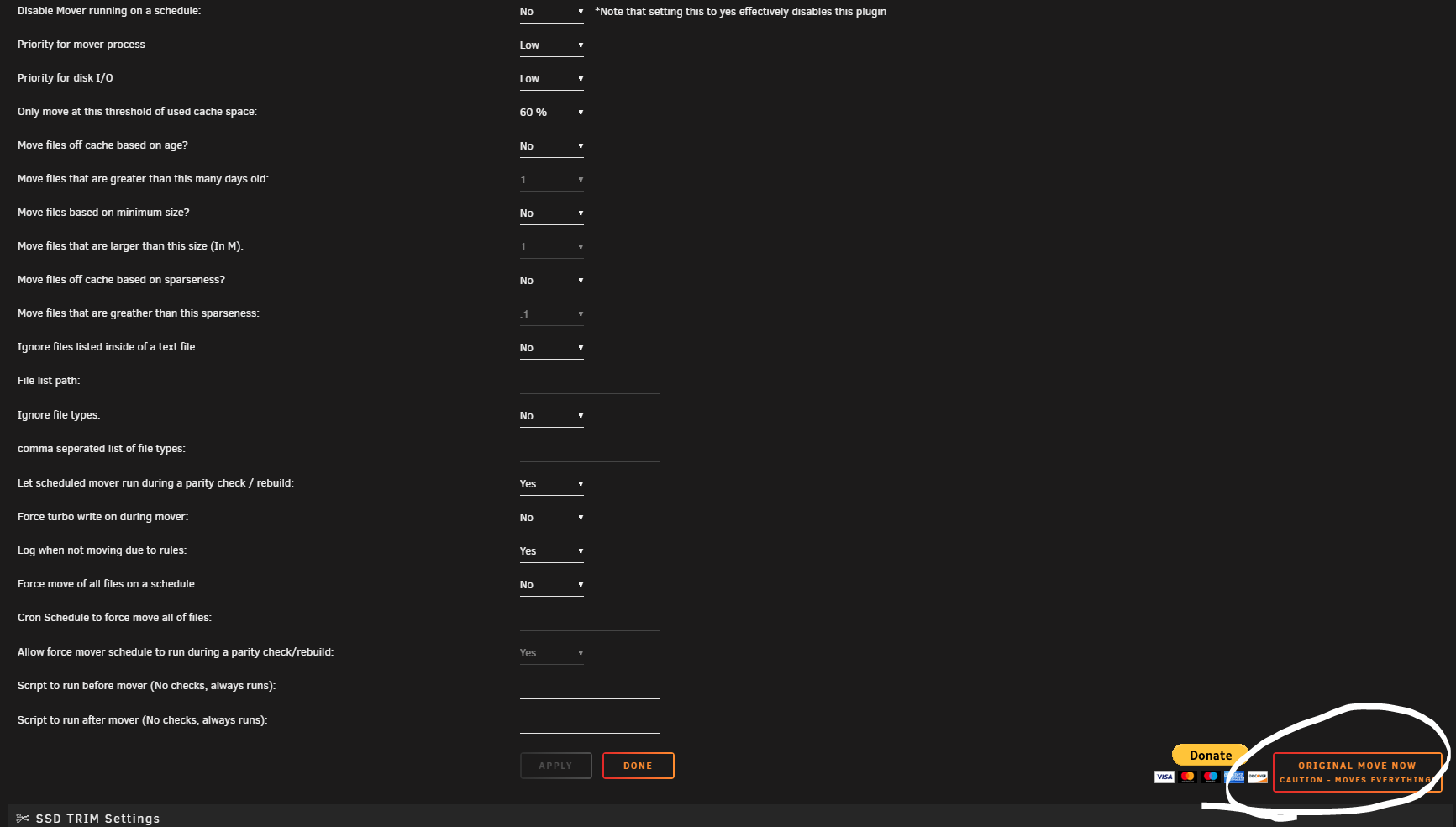

There is some issues with the moving of files automatically at a percentage it seems since the new Plugin Dev took over.
I think it will be fixed in time but he's only been ironing out the problems for about a week.
In the mean time go into settings section and click this down the bottom right. For now you will need to do this manually. i do mine every few days.
It will trigger the mover to work. Also 6.9.2 came out fixing a few other bugs not related to this issue might want to upgrade.

2.) Do you have logging enabled? (Please enable, and upload diagnostics again or "section" of syslog that has mover tuning log entries.

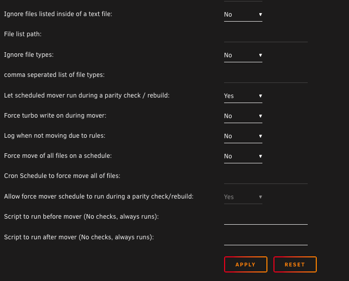

3.) Can you take a screen shot of your schedule/mover tuning settings?

answer to q 3) these were the settings i was running before hand in pics 1 and 2

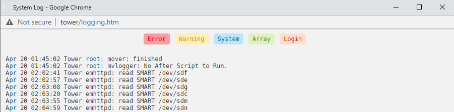

That still looks like the old log, as the new "syslog.txt" in the diag. file is blank (0kb).
If you open up the log from the GUI when it's moving, or shortly after or if you open /var/log/syslog from the console I'm looking for entries like this.  (mvlogger:)
stargate-diagnostics-20210420-1043.zip
now its showing logs

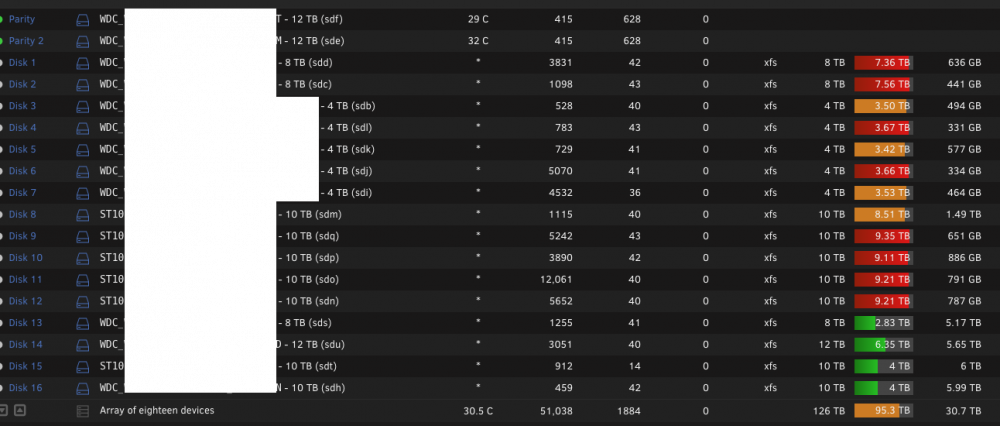

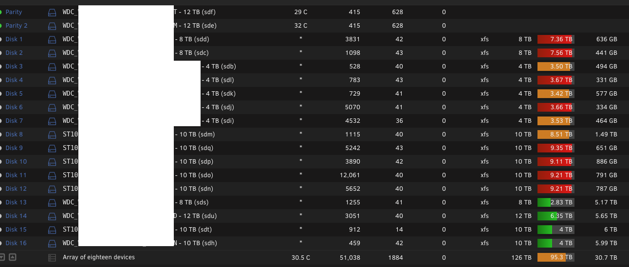

Looks like mover was still running for some reason.
Is Disk14 full?
Apr 20 10:43:18 StarGate move: move: create_parent: /mnt/disk14/appdata/nodered/node_modules/concat-stream error: No space left on device
Also, do you have any shares set to prefer for cache?
The reason I say that is it appears it's trying to move a file off the array (disk14) to the cache. (... is used in place of the whole file path.) (for "use cache: yes", it usually moves from /mnt/cache/<filepath here> to <array>
Apr 20 10:41:51 StarGate shfs: copy_file: /mnt/disk14/appdata/FileBot/Media/TV Shows/... /...v (28) No space left on device
Apr 20 10:41:51 StarGate move: move_object: /mnt/disk14/appdata/FileBot/Media/TV Shows/...v No space left on device
