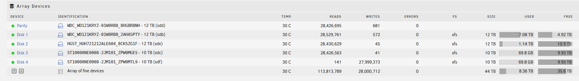

Well, I owe you a big thank you for this one!
The Thecus N5550 I had my disks in was at least 8 years old, so I decided to chuck it.  I have lots of parts laying around, so I constructed a server based on:
Asus X99 motherboard
Xeon e5-1620 CPU
16 GB Ram
...and all my disks.
I migrated everything to the new machine.  I poked around for a bit trying to get the machine to boot from the USB key, but when it did, it fired right up, automatically recognized all my disks, and presented everything to me exactly as it had been set up on the Thecus.
I instructed it to add Disk 4 to the mix (using the Seagate Iron Wolf Pro I had first tried), and 12 hours later it's all good!
Unbelievable.  I'm sold on UnRAID forever.
