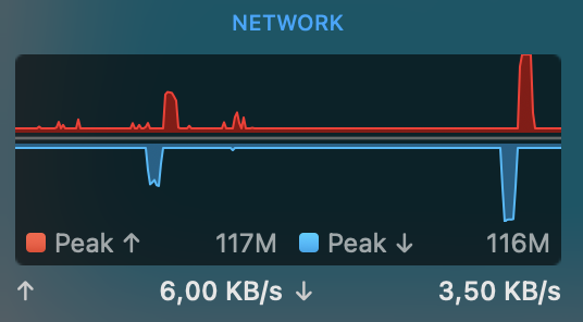

  • I can exclude the network as I can saturate that (tested wit istat, iperf, OpenSpeedTest)
  • 1751790413_Screenshot2021-04-25at8_04_41.png.9e67464e87e78dfafd3f44c88ced8665.png

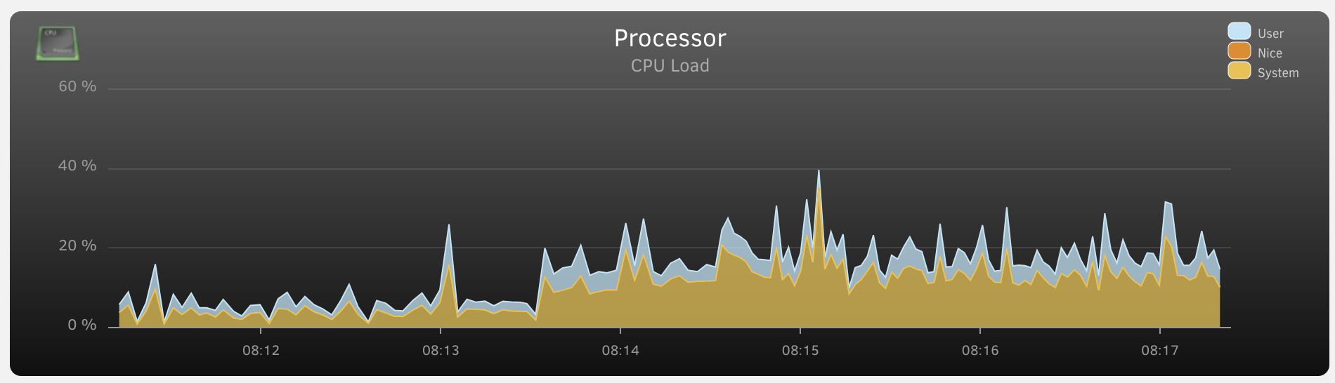

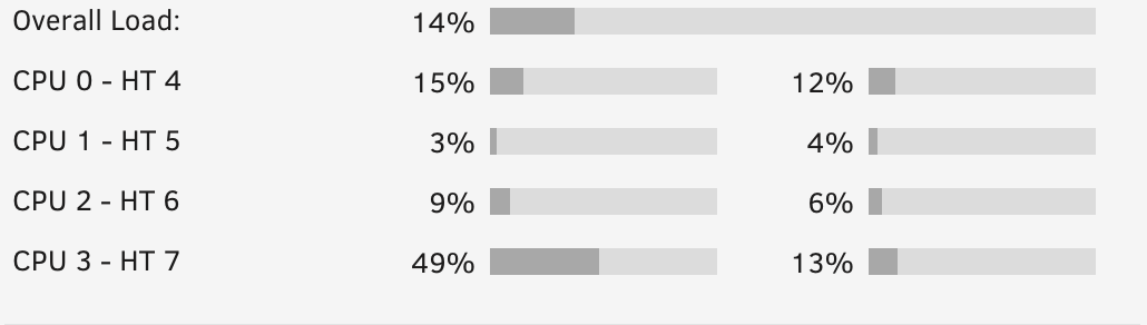

  • CPU seems OK (only rarely 1 core spikes to 100%)
  • 1706724773_Screenshot2021-04-25at8_18_02.thumb.png.f155411ae7b87b0bab0121d7a1249ee2.png

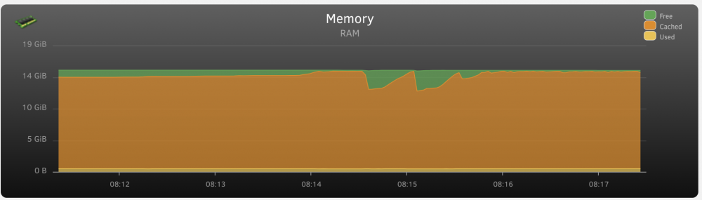

  • RAM seems OK
  • 1683742002_Screenshot2021-04-25at8_18_06.thumb.png.eda6d58bcf7ff4549d0cbc05e3035d98.png

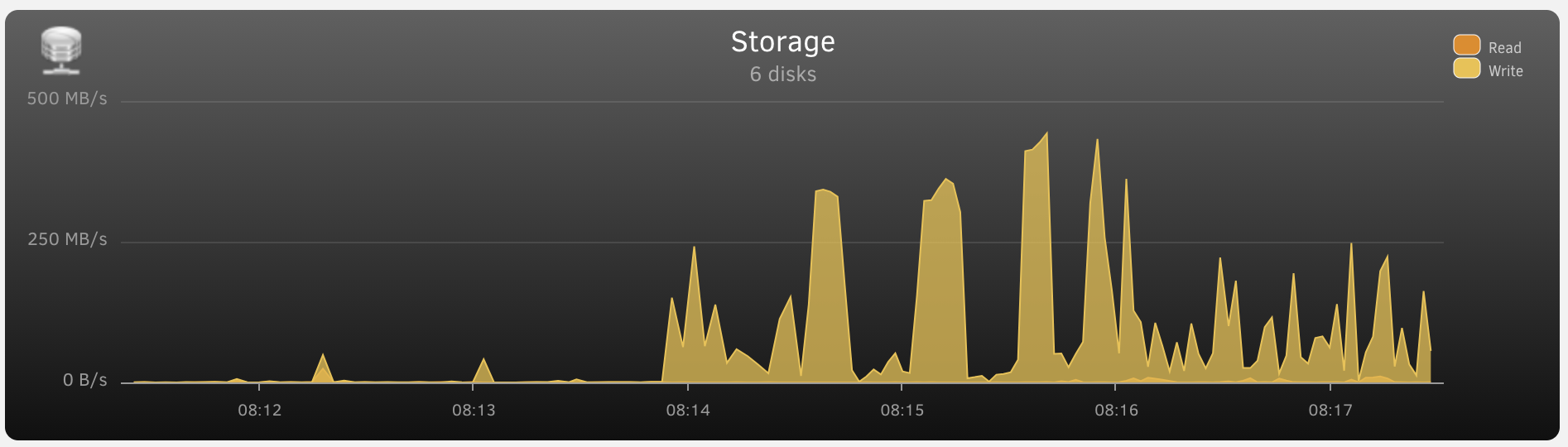

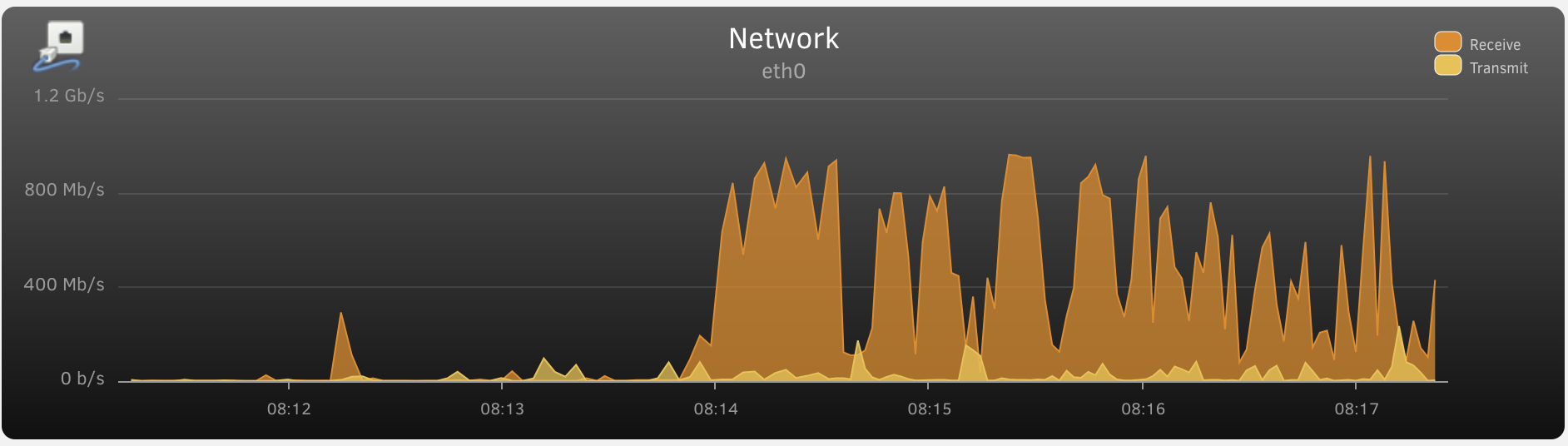

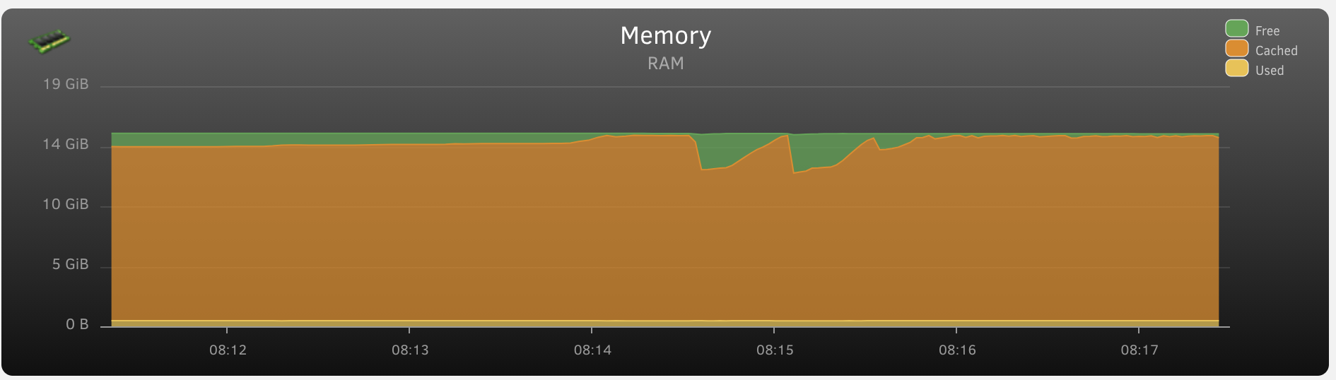

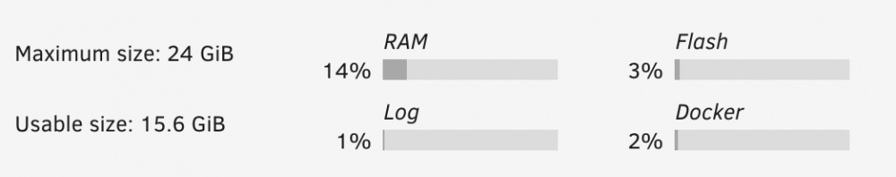

What does not make sense to me is the inconsistency in the speeds, the fact that the RAM is almost all the time full with cached files and that the ssd writes only occasionally.
Is it correct that the RAM does not "clear the cache" after the transfer to ssd?
Lame comment (maybe), but it feels that the speed is dropping when RAM hits the ceiling and all is halted.
These are statistics while copying many streams at the same time (I get the fastest results this way - around 70 MB/s):
360012481_Screenshot2021-04-27at8_17_21.thumb.png.4865fea47aced7fcf5ee1e7e24dc0982.png
543442861_Screenshot2021-04-27at8_17_24.thumb.png.6a84c9bda79de65e5f6b222814716d28.png
237664051_Screenshot2021-04-27at8_17_31.thumb.png.9118ae302a70e9ad3105a46ca4d58cfb.png256874877_Screenshot2021-04-27at8_17_28.thumb.png.87bc828251a800f84b28e8cce5ee6355.png
This normal, no problem.
