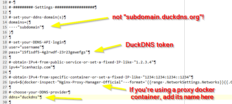

DDNS Updater Script
Execute this script every 5 minutes (custom cron */5 * * * *) through the user scripts Plugin. It opens the DDNS URL only if the IPv4 or IPv6 has changed. By default the IPv4 is obtained through a web service like icanhazip.com and the IPv6 through the servers ethernet interface.
Optionally you can obtain the IPv6 from a specific container:
ipv6=$(docker inspect "Nginx-Proxy-Manager-Official" --format='{{range .NetworkSettings.Networks}}{{.GlobalIPv6Address}}{{end}}')

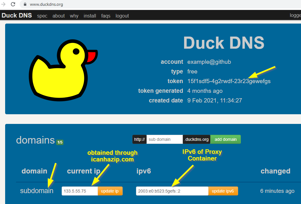

Manual
DuckDNS
Result:
