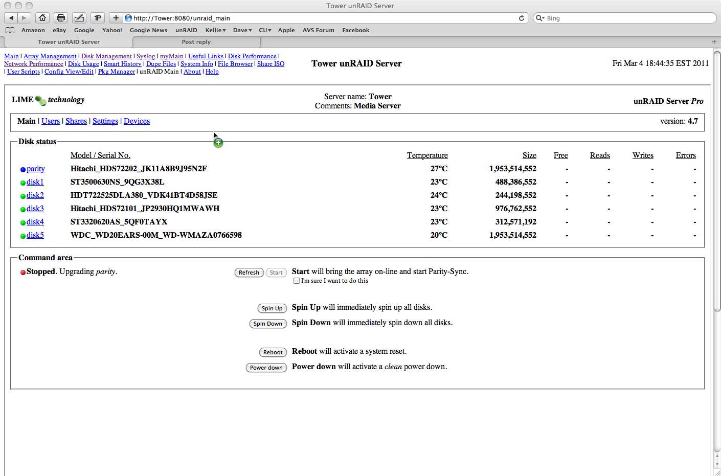

So I just upgraded my parity drive, do I need to hit the start button?  It says its rebuilding parity but not sure if I need to start the array first?  All I did was pre-cleared the drive and then pulled out the old parity drive and put in the new one.
edit....if I would have read my first post I would know that I have to hit the start button, doh

So I just added the drive and started the array and now it says this and is clearing the drive on its own and the array is stopped.  Is this normal?
PROTECTED_EXPANSION, unRAID ARRAY is STOPPED 7 disks in array.    PARITY NOT VALID: DISK_NEW
