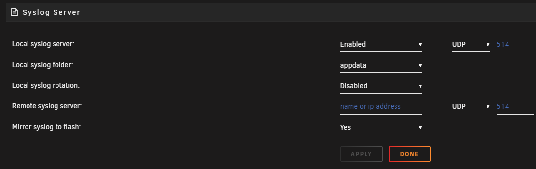

Likely have a hardware problem, you can try enabling the syslog server to see if it catches anything after the lockup.
the previous ZIP i added should containt any errors, cause the Syslog feature is active.
However there are a million folders and files there, so I don't know where or what to look for.
Syslog server doesn't save in the diagnostics, it's a separate log file saved in the path you've chosen.
Okay, so it's NOT this one?
That's the regular syslog, that starts over after every reboot.
Well I only have that from the diagnostic-zip and the one that's in the appdata, but that syslog tells nothing. It just says server is up!

Syslog server log is saved to the chosen path, in this case appdata.
Yeah and it contains very little useful information like I've said thrice now..
But if you can find anything useful please let me know :)
//Magmanthe
syslog-127.0.0.1.log
Edited by Magmanthe
You also have mirror to flash. Look on flash drive for those and attach
In Root-flash there is no syslog.
There is a folder called "logs" and there is a syslog in there, attached.
//magmanthe
syslog.7z
