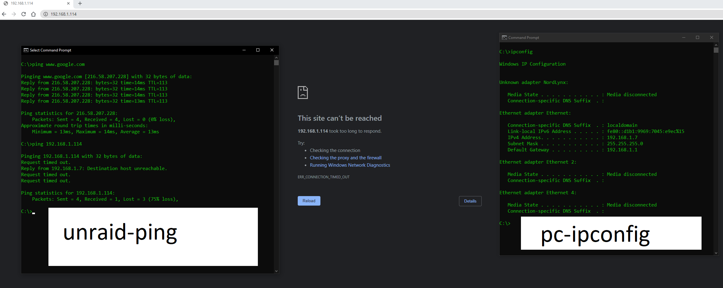

Server spins up again nicely, and logs in as normal. Then after a few minutes (maybe an hour), it becomes totally unresponsive.
playing files from the server does not work, accessing it via file-explorer does not work, WebGui unresponsive, as locally connected screen/mouse/keyboard also becomes completely unresponsive.
Only "solution" I have found is a hard-reboot, pressing the reset-button the the chassis.

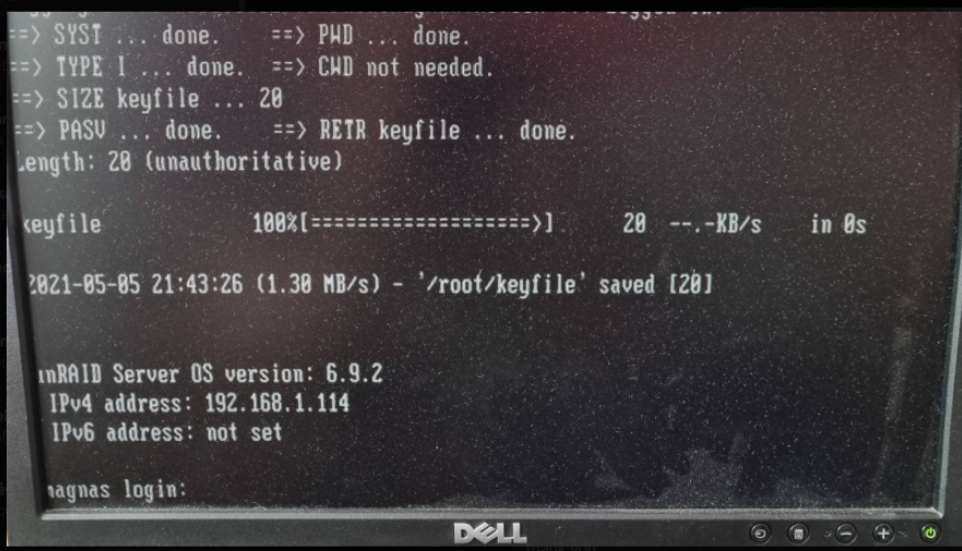

Then once the server turns back on, what happened previously was that one of the disks fell out of the array. Red X in the Main-screen with "Device is disabled, Contents emulated". This happened to my smallest Disk 4 and my workaround to deal with this was just to stop array, take out the disk, start the array. Stop the array again, include the disk and rebuild it.
Now yesterday this happened again after the update, but when I reboot the server now, it is no longer my Disk4 that fell out, but my Parity 1 and Disk 1 doing this, which is weird, cause that's new.
I have activated the syslog-server from Settings, but that log is worthless, it only says
May  4 20:39:38 magnas /dev/log [info]: Server is up! /var/run/unraid-api.sock
May  4 20:39:45 magnas /dev/log [info]: Server is up! /var/run/unraid-api.sock
May  5 11:37:10 magnas /dev/log [info]: Server is up! /var/run/unraid-api.sock
May  5 11:37:16 magnas /dev/log [info]: Server is up! /var/run/unraid-api.sock
May  5 13:33:42 magnas /dev/log [info]: Server is up! /var/run/unraid-api.sock
May  5 13:33:48 magnas /dev/log [info]: Server is up! /var/run/unraid-api.sock

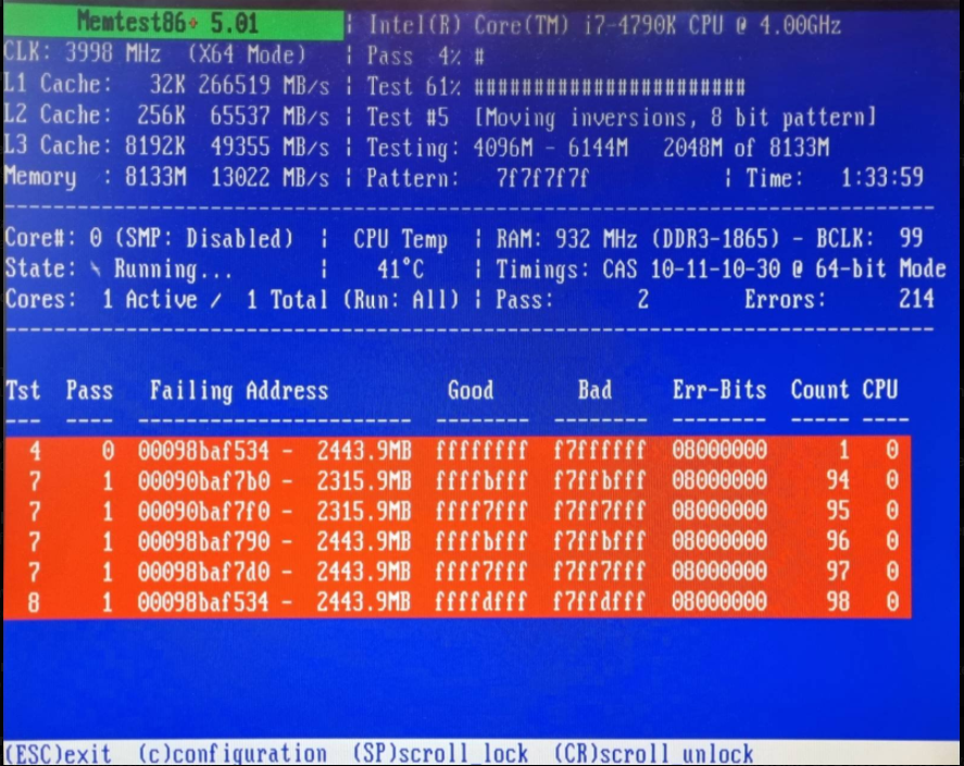

quick update..
i know to check sticks separetly, but did a quick-check with all 4, and it spit out errors (just as a sanity check)..
So there is for sure something wrong with one (or more), so I'll pull the sticks and check them one-by-one..
Thanks for the tips, didn't even consider it to be a RAM-error...

Hi again,
So I've now run MemeTest on all 4 sticks, and wouldn't you know... 1 of them was really bad.
3 passed fine without any errors, but the last is garbage as you can see from the pix.. Luckily I did have a spare so no biggie..
So thanks for pointing me in that direction :) much appreciated.. Didn't think of that at all..

So I'm back with an update..
Since yesterday, I came back from work today to check the Rebuild-progress, and lo and behold the "unresponsiveness" is back.
System is all locked-up (both from WebGui) and from direct-connected mouse/keyboard/screen.
However instead of hard-resetting and turning the system off/on at the current time, i will leave it on until tomorrow morning (Friday) just in case the actual parity and disk-rebuild is still going on in the background. From experience I know it should take around 1 day and ~3-5 hours, and I started it at around 22 yesterday.. So around midnight tonight (if it is still going) it will be done.
