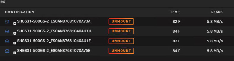

I have 4 SSD drives all spec'd at 500+-R/W (I know they wont get that all at the same time in the server) I have them in a Dell R630
They write to the drives about 75-125MB/s in Unraid Gui Per
The data that I have on them ends up being 110GB roughly (yes chia plots)
I then transfer them to another unraid server on my network that has an NVME cache drive then it dumps to the array. The problem that I am seeing is that they max out at 5.5-6.3MB/s ea and it TAKES forever to xfer to the receiving unraid NVME drive over the network. My network is gig and not saturated by anything else.
I know the NVME in the receiving server can keep up, as I have another unraid server pumping plots in over the network and it transferred 220gb from a NVME to the receiving nvme in less then 30min.
So I need to change network settings on the Dell to have more connections to the switch and maybe Mode 5 - so the send and receive are on separate ports? I am at a loss at why these SSD's can not transfer fast and they are not maxing out my gig connection?
Any thoughts would be helpful.
