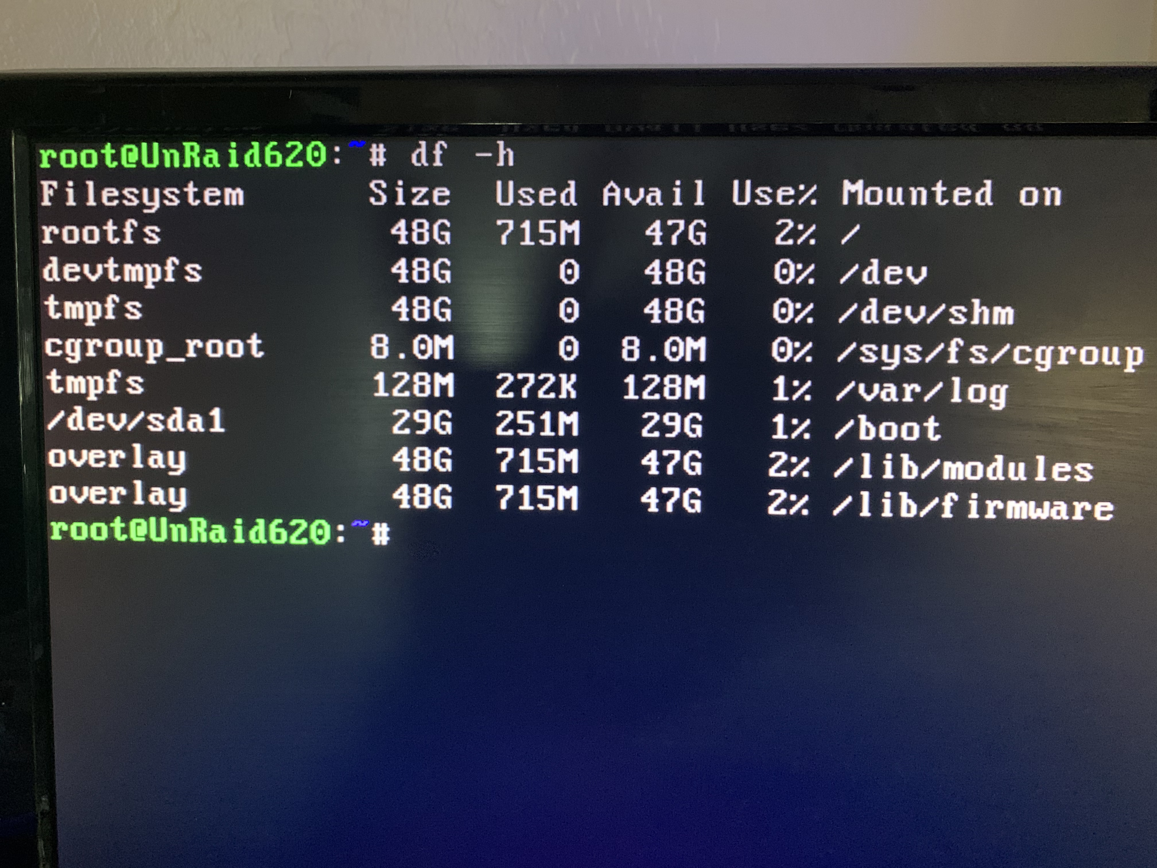

sorry just got home...working on the dh -h for you now and thanks for the boot info

Here is the ‘df’ you requested
Ok - that shows that the flash drive `has been mounted.   On that basis I would expect the network connection to be  active.    You mentioned trying the IP address - what IP address was that?    If there is no network I would expect it to be one of the form 169.x.x.x which is what you get if no DHCP server can be contacted because there is no active network.
