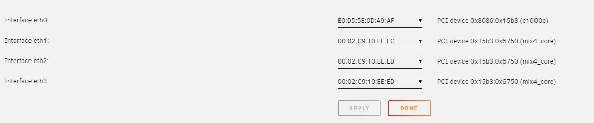

I got myself a Mellanox ConnectX-2 Dual SFP+ card. It appears in unraid, but there is one problem.
I get three interfaces from it, and two of them have the same MAC Address. So I am unable to make changes what is eth0, eth1.. etc because of that.
I get an error saying there is a mac address duplication
I guess I need to some how remove eth3 from the interfaces.
Has anyone experienced anything like this?

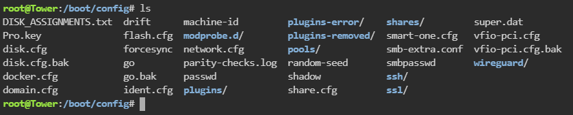

Try deleting /config/interface-rules.cfg on your flash drive and then reboot.
Thanks for you comment.
There is no interface-rules.cfg files there unfortunatly
That's odd since it should exist every time there's more than one NIC, delete/rename network.cfg and reboot, note that network settings will revert to defaults.
I'll try that
But right now the mellanox card is not installed, as I gave up on installing it yesterday, because it made it impossible to use eth0 as my old nic to get internet to my Unraid server
I do have 4port i340 card installed, but it is bounded to pfsense VM, so perhaps thats the reason why i have no interface-rules.cfg
Thanks for your help

I tried deleting the network-rules.cfg and reboot. Did not work, came back like this.
Aslo tried deleting the duplicate line of eth3 and rebooting. Did not work, came back like this
Any more ideas?
My diagnostics file is attached
edit:
Is it possible that the conflict is that it is sharing an IOMMO group with the PCI bridge?
IOMMU group 1:				[8086:1901] 00:01.0 PCI bridge: Intel Corporation 6th-10th Gen Core Processor PCIe Controller (x16) (rev 07)
 	[15b3:6750] 01:00.0 Ethernet controller: Mellanox Technologies MT26448 [ConnectX EN 10GigE, PCIe 2.0 5GT/s] (rev b0)
tower-diagnostics-20210519-0051.zip

The kernel is renaming eth2
May 19 00:33:23 Tower kernel: mlx4_en 0000:01:00.0: Activating port:1
May 19 00:33:23 Tower kernel: mlx4_en: 0000:01:00.0: Port 1: Using 12 TX rings
May 19 00:33:23 Tower kernel: mlx4_en: 0000:01:00.0: Port 1: Using 8 RX rings
May 19 00:33:23 Tower kernel: mlx4_en: 0000:01:00.0: Port 1: Initializing port
May 19 00:33:23 Tower kernel: mlx4_en 0000:01:00.0: Activating port:2
May 19 00:33:23 Tower kernel: mlx4_en: 0000:01:00.0: Port 2: Using 12 TX rings
May 19 00:33:23 Tower kernel: mlx4_en: 0000:01:00.0: Port 2: Using 8 RX rings
May 19 00:33:23 Tower kernel: mlx4_en: 0000:01:00.0: Port 2: Initializing port
May 19 00:33:23 Tower kernel: mlx4_core 0000:01:00.0 eth3: renamed from eth2
Try removing eth2 as its not a valid port as was renamed.
Appears to be working!
I deleted eth2 from the network-rules
Thank you so much
https://imgur.com/HpiOjBq
Now I don't have a multiple MAC address
Pretty strange problem though
