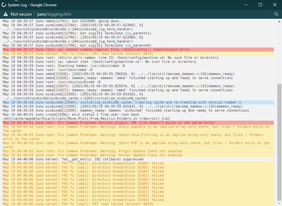

I got "flash device error" in the upper right corner of the Unraid GUI.
"Go to Registration page" doesn't work, nor any other page.
Tried going to "Flash" share and it's empty.
I can't get diagnostics through CLI because log goes to /boot, which is empty.
syslog looks a mess. I managed to copy the flash backup  minus bzroot and bzroot-gui files because it keeps restarting the Samba service.
Any ideas? turn off the system, use the Flash Creator tool, then copy over the backup files to the thumb drive?

Attached syslog - copied manually.
syslog.zip
Flash drive dropped offline, if using a USB 3.0 port try USB 2.0 instead.
Shutdown and restart of the server was enough. I had some issues yesterday connecting/disconnecting external NVMe disks through USB enclosures.
Probably this caused the issue.
