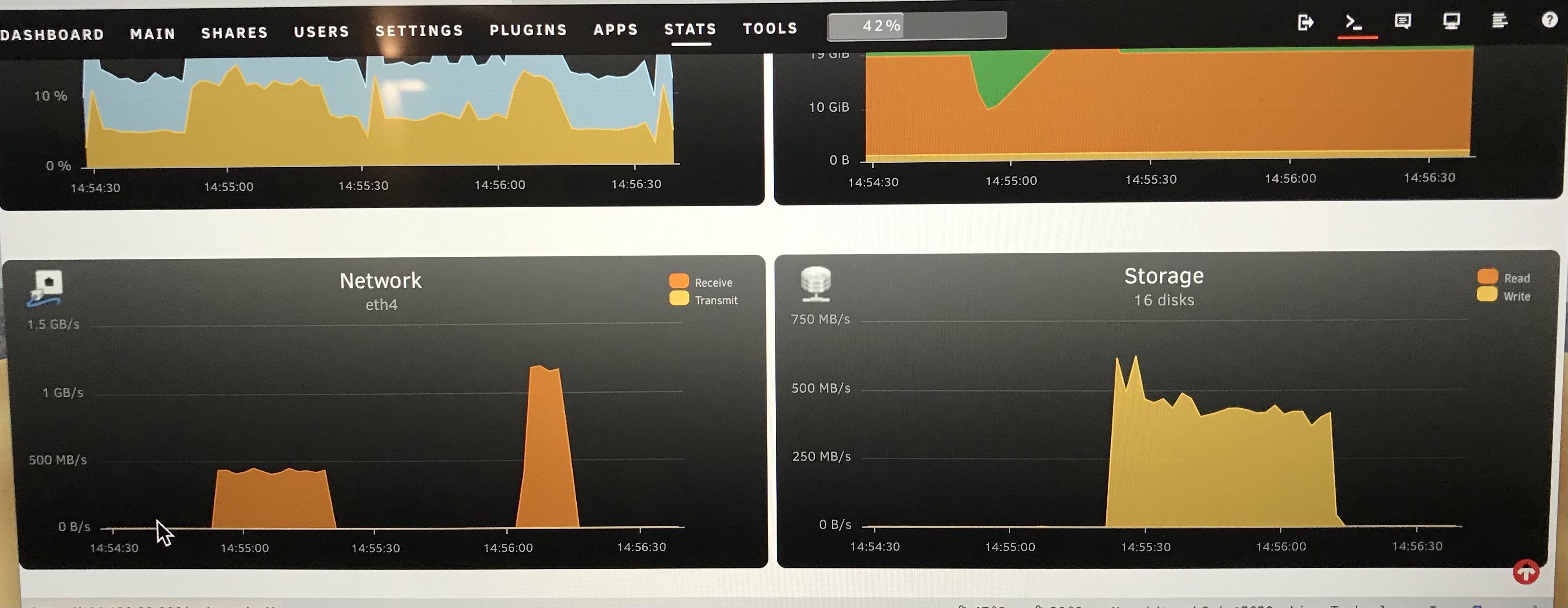

Thanks Sir  for the hint, I tried to flush the cache, it actually shows no ram usage, 30Gb free, all dockers stopped.
Iperf3 shows a healthy 9.7Gbits average. Transferring files shows a ramp up in ram usage until saturation, but transfer speed to the cache enabled share tops out at 4.8Gbits/s, reading from cache shows 450Mb/s which is normal speed for my ssd sata drive.
I changed the dirty cache parameters, but it alters just the time when the flush to the ssd drive happens not the speed, it actually doubles the time because the file will be first written to the Ram at 4.8Gbits and than to the ssd at circa the same speed, not writing to Ram results in faster total writes.
might it be the way unraid handles Shares? Is there a way to write to Ram only bypassing the shares, just for test? Like a ram disk/ram share?
I also tried blackmagic speed test, directed at the cache enabled share, and it shows 450Mb/s write and 515Mb/s read, which, to my understanding should be the speed of the ssd and not the Ram, right?

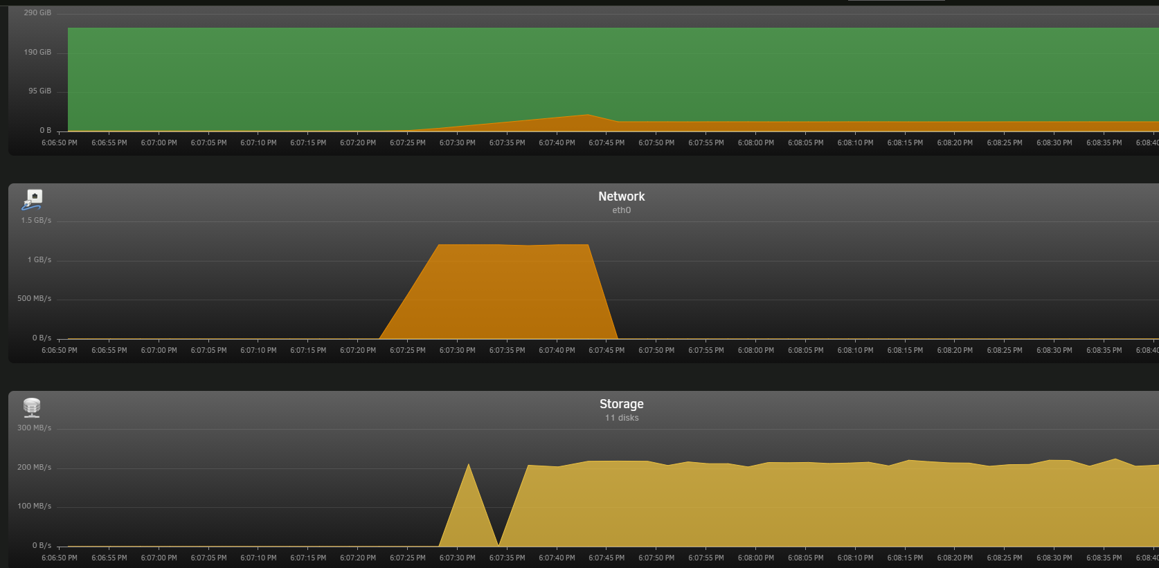

Belwo is a test FYR ( 23GB file with MTU 1500, file writing to RAM and it also flush to array disk slowly .... when whole file writing to RAM, the usage will slightly drop )

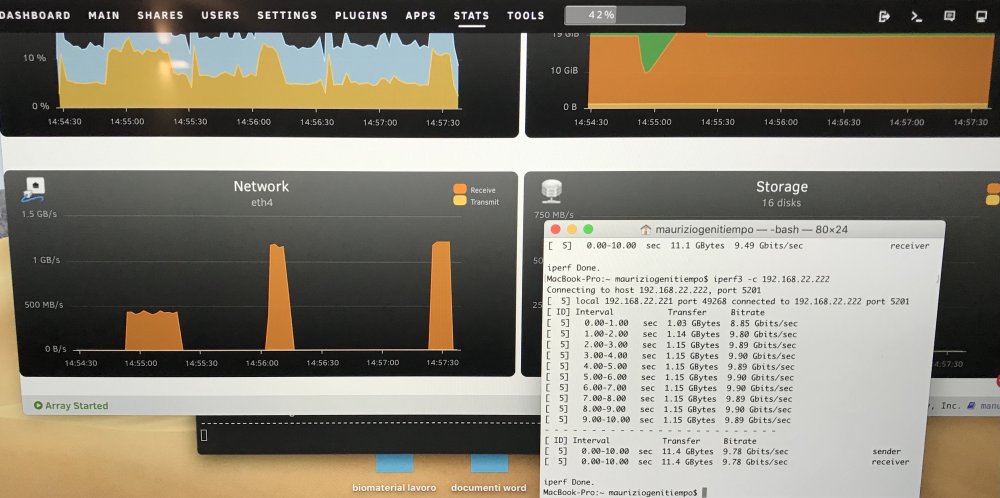

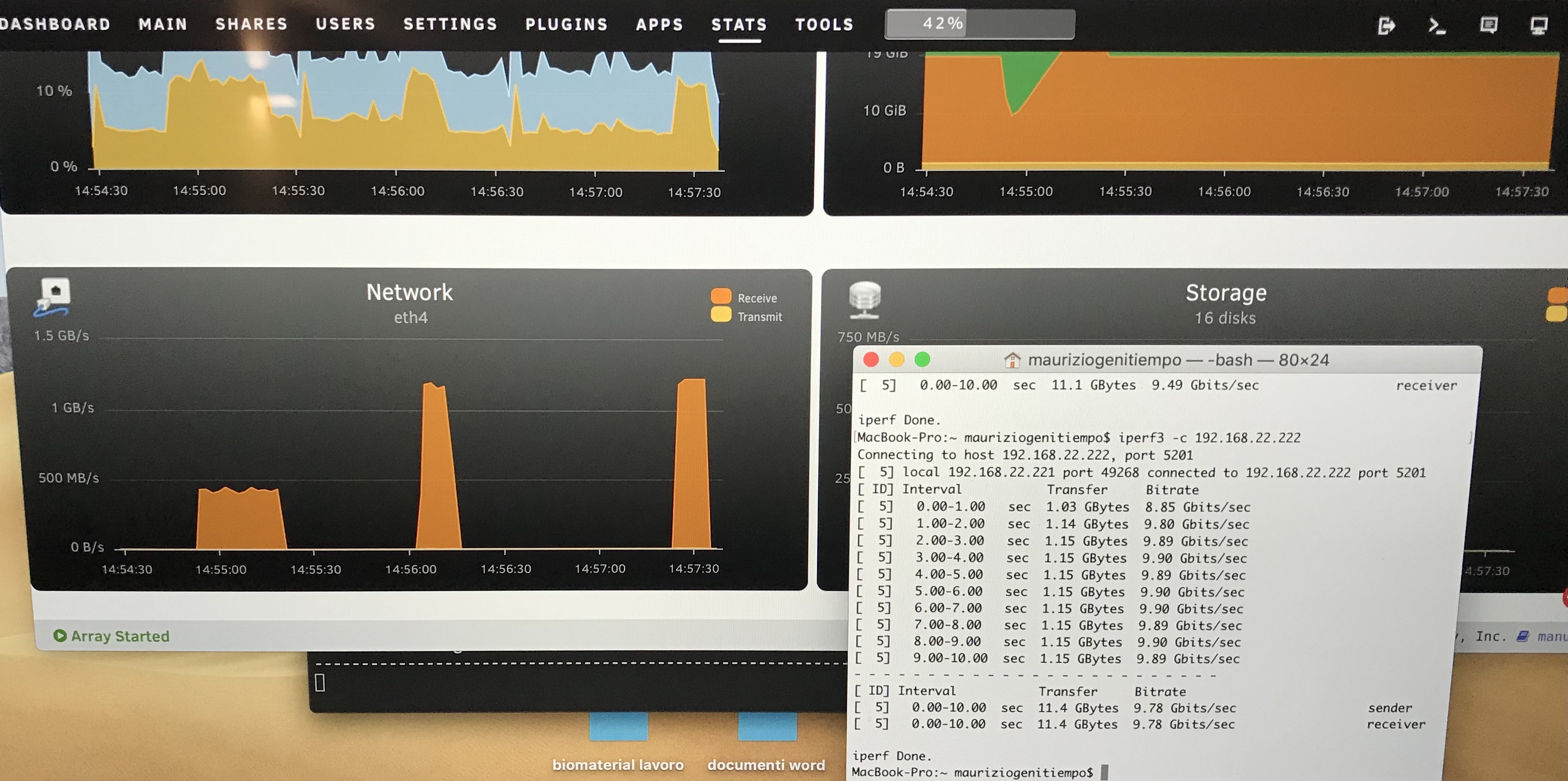

Thanks Sir, I tried as you said, no changes, I tried to make a peer to peer connection to bypass the switch and connecting directly the computer and server, no changes.
i send two screenshots where you can see the transfer rate during file transfer and during iperf3 test, which indeed shows 1Gb/s
