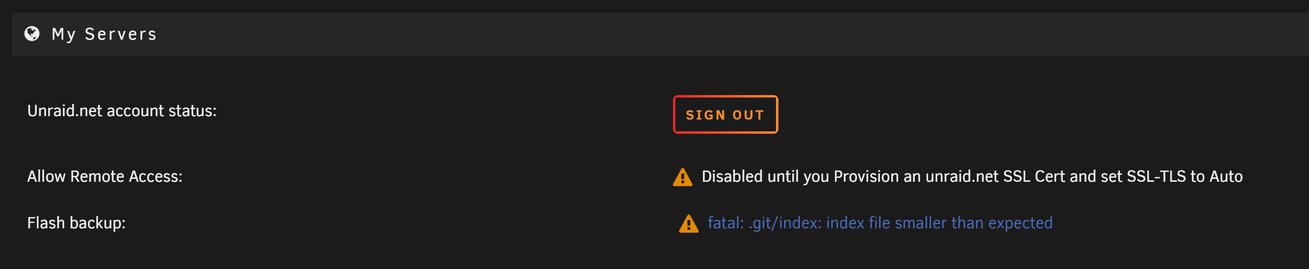

I installed and setup the My Servers plugin in April and all was good.  I hadn't thought about it for a while, so I opened up the plug-in and saw that the flash backup (which originally was working fine) was now showing "fatal: .git/index: index file smaller than expected", as you can see in the screenshot I'm including.  I have rebooted my server, signed out and back into My Servers, uninstall and re-installed the plug-in, and so on.  All the while My Servers shows that it's online.  I've also not been able to find any posts on the community or internet in general regarding this error.  I'm hoping someone here is able to help, as a regular flash backup would definitely help me sleep easier at night!  Thanks in advance.
P.S. I'm running 6.9.2.

I just fixed it for myself. I did the following steps to get it working:
*wiped the /boot/.git directory
*removed /var/local/emhttp/flashbackup.ini
* then manually initialized with  php /usr/local/emhttp/plugins/dynamix.my.servers/scripts/UpdateFlashBackup.php activate
Perhaps more checks are needed on a reinstall to remove the .git directory and any leftovers from a previous install to prevent this?
Edit: the last step may have been unnecessary to manually activate from the CLI. I did not refresh the myservers page in the GUI to see if it would work automatically. I can say for sure that just removing the .git folder under boot was not enough, though.

Just followed this and it worked for me.  Flash backup is not functioning!  Woohoo!  Thanks.
