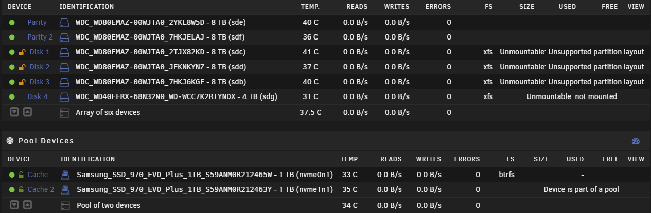

I had an array of 6 drives (2 as parity) on the onboard SATA controller, and needed to add more drives so I installed an adaptec 71605, plugged everything up, and configured the card as HBA. After booting Unraid and starting the array the parity is happy but all data drives would not mount. I've read through many threads, these two in particular, and adding to the mess is that these drives were encrypted.

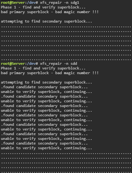

I attempted to start the process mentioned in the first thread. Removing one data drive and starting the array did not successfully emulate the missing disk. I attempted to mount the pulled drive, scan file system, etc, but nothing worked. I also put that drive back in the array and performed a rebuild. The rebuild completed successfully, but it now shows "Unmountable: not mounted". Since I'm not a linux guy I'm reaching out for help. I do have backups of the important data but there's another 20tb+ of data that I'd love to recover.
Here is the current state - Disk 4 was the one I tested and rebuilt.

I forgot to mention that after the drives came up as unmountable I immediately removed the Adaptec card and connected the drives back to the motherboard controller. So, they are currently in the original physical configuration.

This can indeed complicate thing, if the luks hears are damaged the filesystem can never mount, can't really help with encryption since I don't use it but there are some threads here about rebuilding the encryption headers, look for those.
I have no backups of the luks headers, so it seems that I'm screwed. I'll be starting fresh. Thanks for responding, JB.
