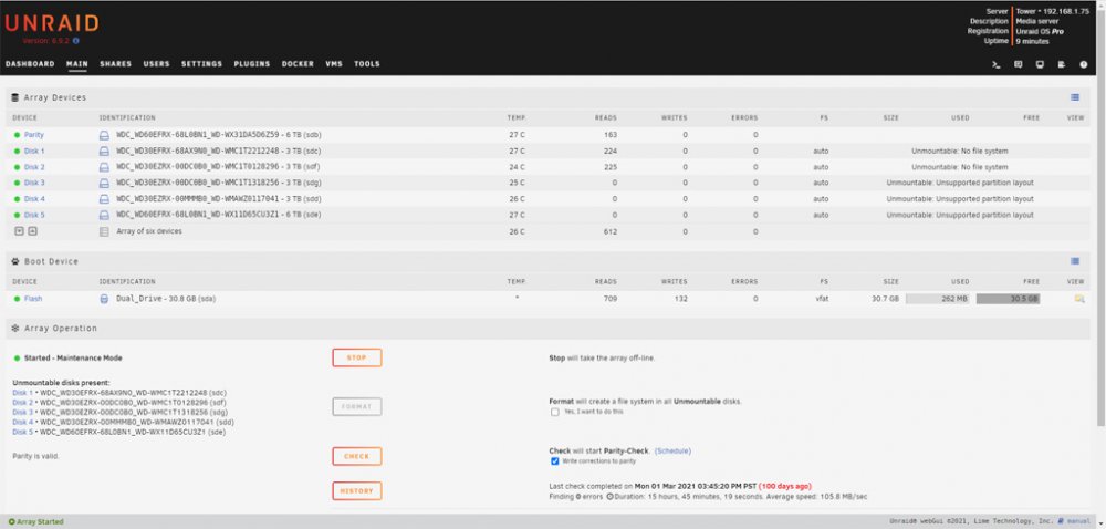

- Array started and new messages beside my drives, please see screenshot

I assume sdf was a drive you rebuilt, and that would recreate the partition, but the other drive is missing the partition, which means something (or someone) deleted them, if your original flash drive was also deleted you were likely hacked, there were multiple cases of that recently, to users you had the server exposed to the Internet, see here for more info.
