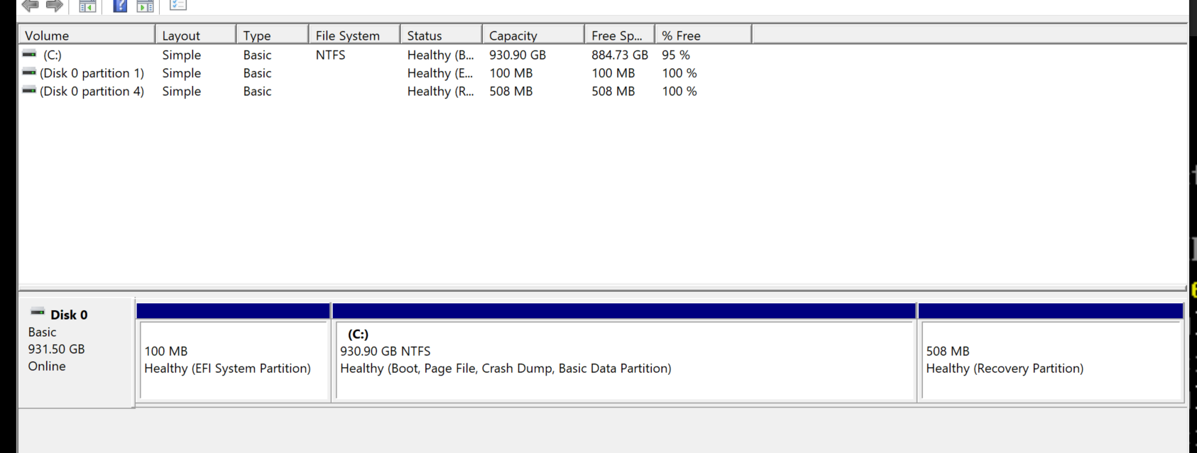

2 hours ago, comet424 said:
so how do i know if i booting in UEFI on a physical machine
Look with a disk utility if you have the EFI partition, if you have it you are booting uefi, if it's not you are booting legacy.

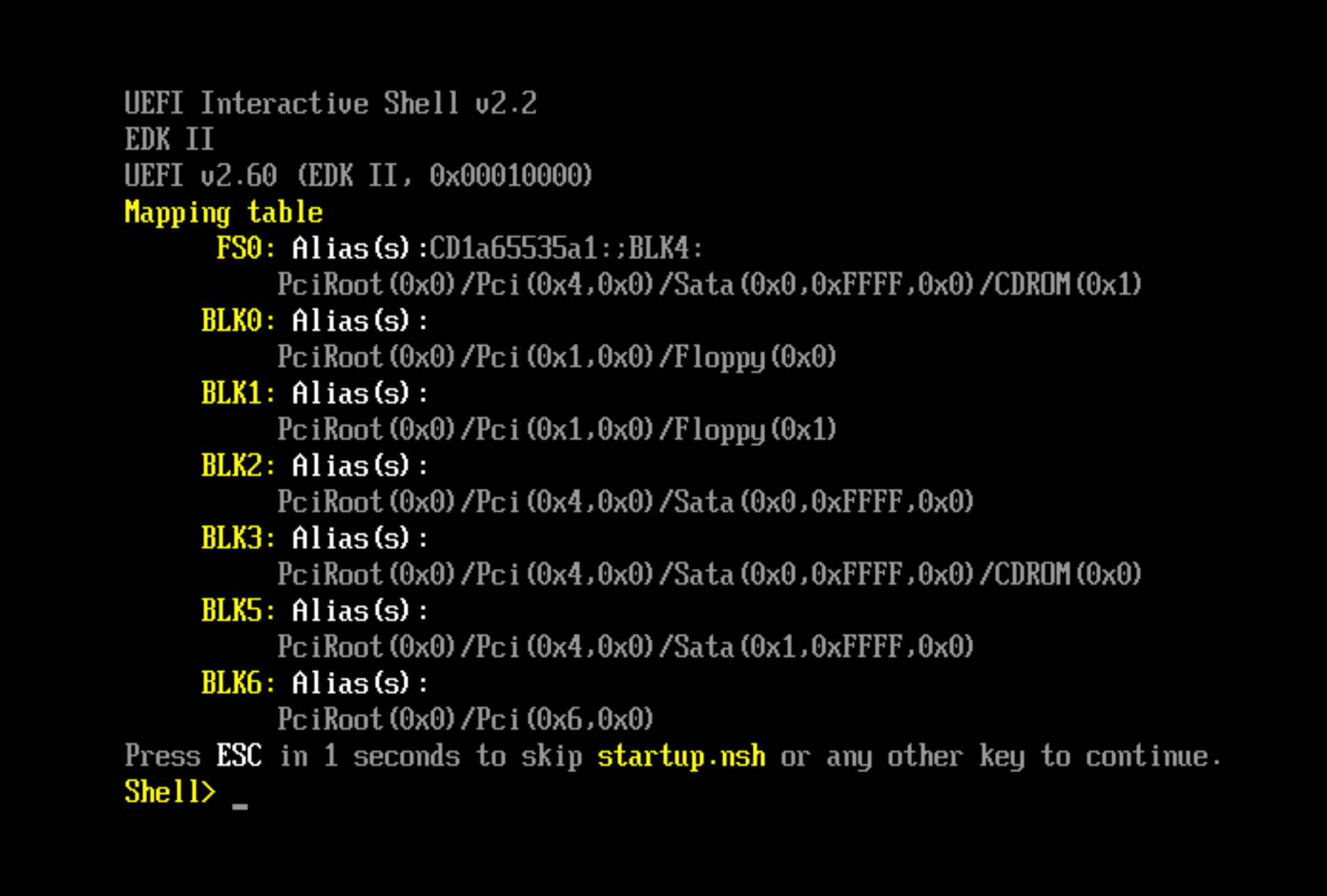

so the screen i get  ins the uefi interactive
thats if i set it to OVMF   i get that in the VNC   on a ISO Windows 10..  now if i change it to Seabios  it will boot into the install

so i guess my physical install is EFI?  since it says in diskpartition there EFI..
Ok, now I understand.
Just to make sure the settings are correct:
make sure that as soon as you start the windows virtual machine you are fast enough to access it with the built-in vnc so you can see the "press a key to boot from cd rom": without pressing a key to boot from cd rom the vm will fall back to the uefi interactive shell. Try multiple times, it can be a bit tricky, because you have to be fast enough.
Try also to press the esc key multiple times as soon as you start the vm: this will show the ovmf bios menu: go to boot maintenance manager --> boot options --> change boot order, click enter, the with the arrow keys select your cd rom and move it to the top with the + key; press f10 to save, go back with esc till the first page, then click reset.
If there is an efi partition your installation is uefi.

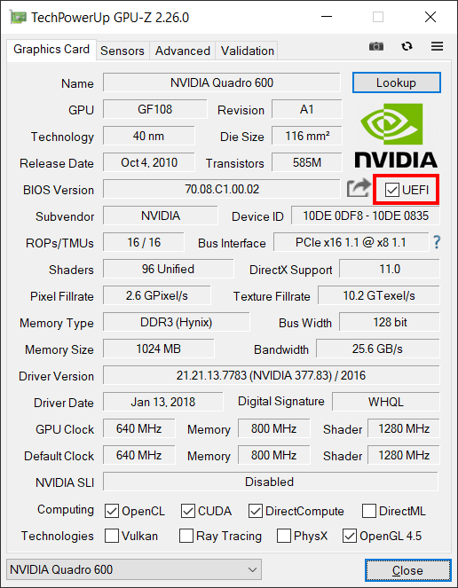

and i dunno if my Video cards support UEFI
the amd HD 7770 should not support uefi, see here:
https://www.techpowerup.com/vgabios/115032/ati-hd7770-1024-120119
It says uefi supported: no
And also the amd 7950 should not support uefi:
https://www.techpowerup.com/vgabios/124572/ati-hd7950-3072-120706
So, most probably ovmf+gpu passthrough will not work, ovmf+vnc will work.
You can check it with gpuz in windows, see the image below as an example: if the gpu supports uefi, there will be a check next to "UEFI"

so far i havent gotten into the setup fast enough keeps getting that screen i posted.. why does that screen pop up?  is there a way to slow down vm  install so i can press any key for the usb/dvd install?  its a pain  how come i dont have a problem going seabios but ovfm i do?
ill keep trying
or i was thinking of doing a regular install on Bare machine and then convert it to a VM?  so   i can run 2 machines at once.. or is it really worth it???
so ovmf creates the efi partition and seabios doesnt.. so  windows will still boot using non efi  if there is a efi there.. just the efi offers more features basiclly is that how that works
See also this:
I think you can start the installer from the uefi shell too.
If there's an efi pa rtition windows boots with ovmf, if there isn't windows boots with seabios.
