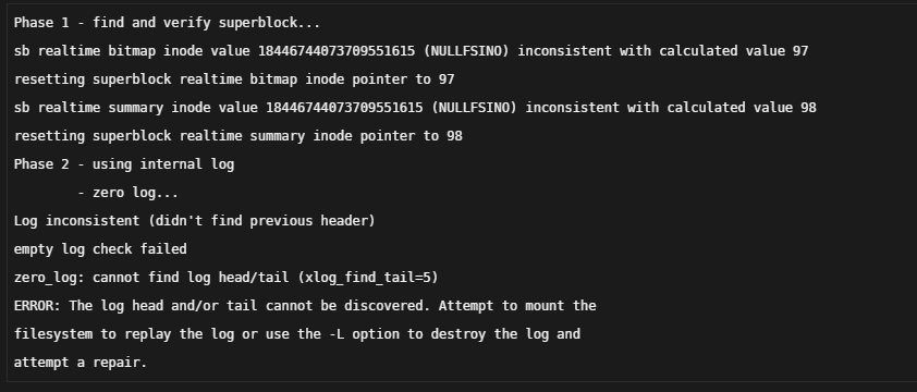

This is the output.
Is that going to delete my data?
No
The -L option just deletes that log and not any of your data. Since Unraid already says the disk is unmountable, there is no way to mount it to replay the log.
