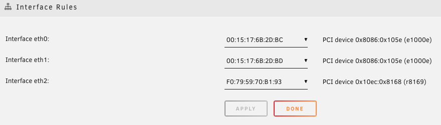

Settings -> Network Settings then scroll down to Interface Rules and assign your NICs by their MAC addresses to eth0, eth1 and eth2. Make the one with the Internet connection eth0.
Like this:
this already the case, but I still see eth2 being used
