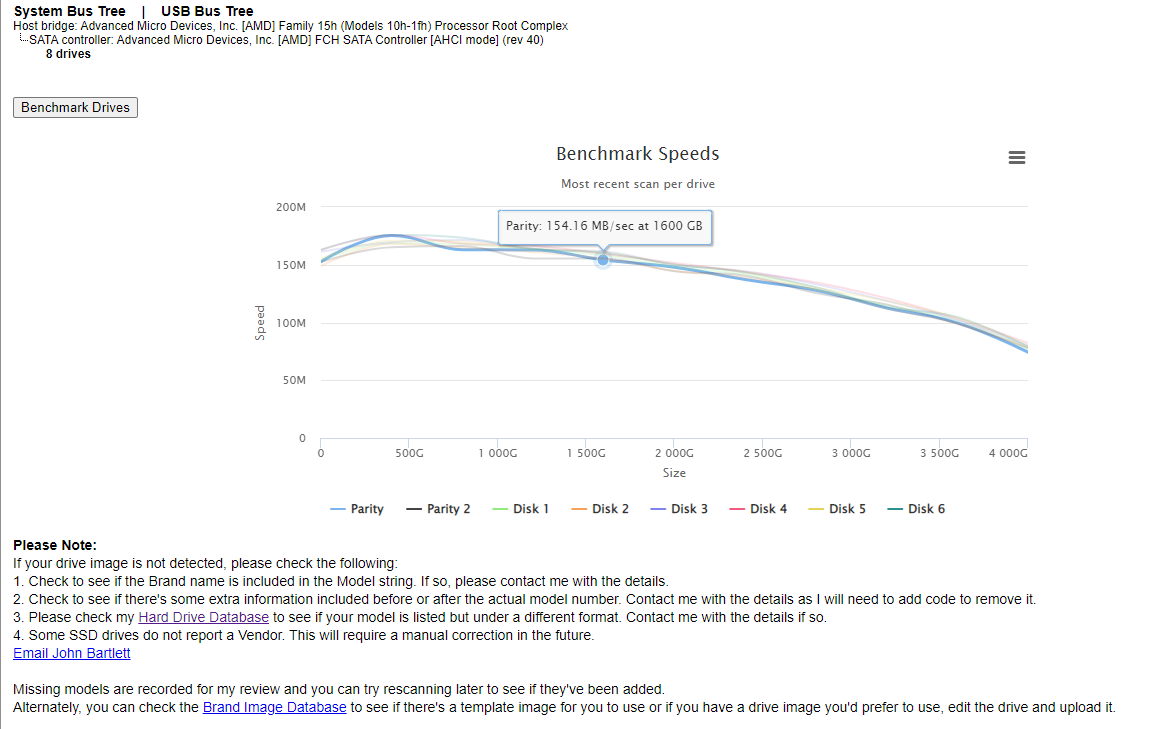

And the source is fast? From what I've seen so far looks more like source problems, do you have a different computer you can test with? Also run a diskspeed docker read test to confirm disks and controller are performing as expected.
I don't have another pc to test this particular problem.  The files that i mostly transfer to my NAS device are mkv, m2ts & flac files.  See attachment for more information on the Diskspeed results.
That looks normal, what's the source device? Also to rule out anything array related assign one disk as a single pool and tranfer to it, if it's still slow it's likely a source problem.
The source device is an old SATA hdd so maybe that's why the transfer speed is so slow.  When i am copying the same file from a M2 ssd to my NAS it's 100mb/s.  I also installed the unassigned device plugin but i don't have the place to add an extra disk/ssd in my NAS because it's already filled with eight 4TB hdd's.
Likely, especially if it's faster from a different device.

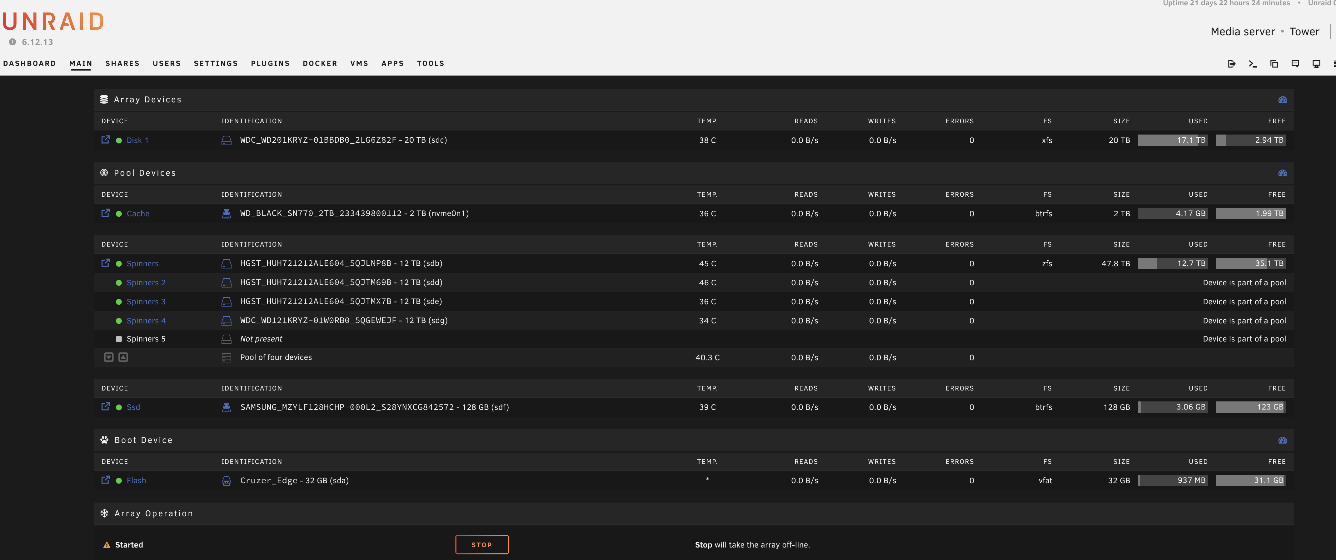

To be honest, I don't have the best knowledge. I appreciate any help.
I am attaching a picture from my nas hard drive tree so you can see plus a diagnosis
tower-diagnostics-20241002-1735.zip
And this?
On 9/27/2024 at 10:49 AM, JorgeB said:
post the results of a single stream iperf test in both directions.
See here if you don't know iperf:
