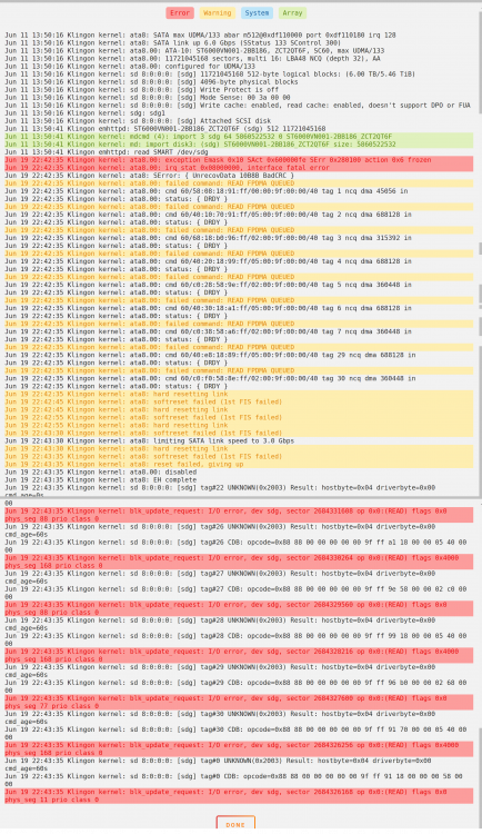

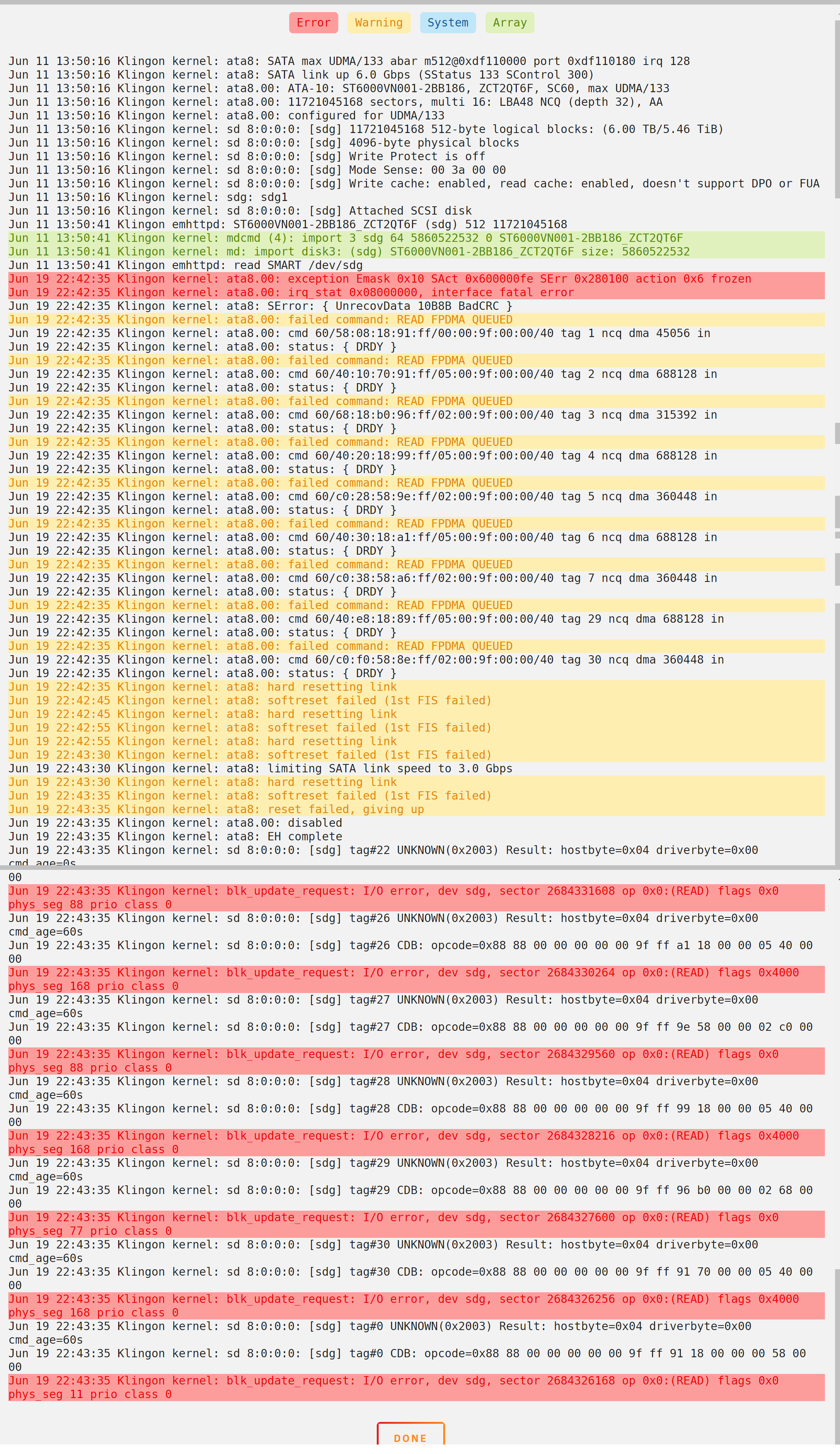

Set up:  Seagate 6 TB drive X 3 + WD 4 TB x 1 + a cache SSD.  One 6TB drive is the parity drive.  The drive disabled is "Disk3" the most recent drive that I added to the server.

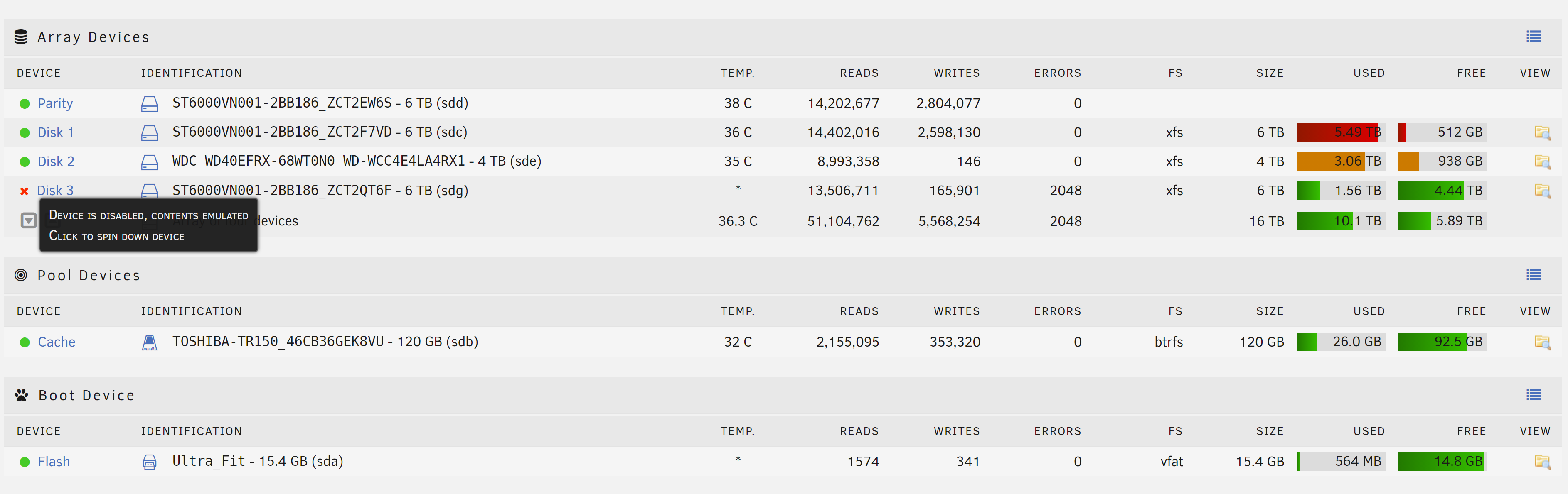

Woke up this morning and one 6TB drive is "disabled" and in "emulation mode".  I can read files that are on that drive but I'm assuming "emulation mode" means it's because of the parity drive.  I don't know enough about any of this so please bear with my ignorance.  I looked around some of the posts and here's what I did
The disk "error log" is posted below.  The diagnostics is also posted below.  This happened once before months ago and at that time I inadvertently rebooted the system BEFORE collecting the diagnostics file but this time didn't do so (thanks to you guys reminding me).  At that time basically the "parity backup" kicked in and the disk was reconstructed and we could never figure out why this happened.
What do I do now?  Is the disk gone bad?  This is a fairly NEW drive so I'm going to be pissed if it's a disk hardware error
Many thanks in advance!
Snag_1f300378.thumb.png.cd1d8ca4700d5fa9c311cfc002c40eec.pngSnag_1f304052.thumb.png.9b87b52176b175235fea385311ac851f.png
klingon-diagnostics-20210620-0924.zip
The diagnostics just show that the drive dropped offline for some reason with no obvious cause that I can see.   Because it has dropped offline there is no SMART information for that drive in the diagnostics to give an indication of its health.

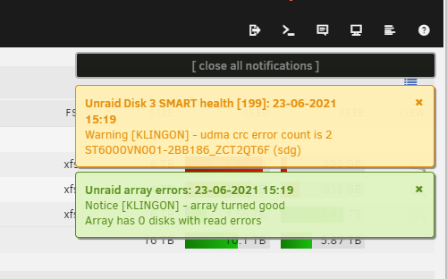

Dear Smart People

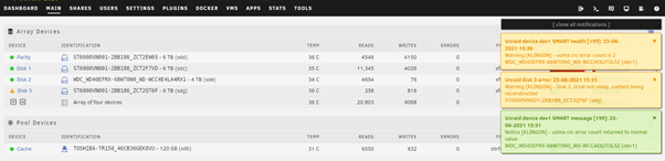

OK I went out and bought new SATA cable for the drive that seemed to be on holiday.  Did a shut down, replaced the cable and then turned it on.  Got this message immediately (see below) and then, as suggested, ran a second diagnostic run (attached).  The drive is still 'disabled'.  Will be grateful for suggestions

Thank you that's great to know.  Here's what happened

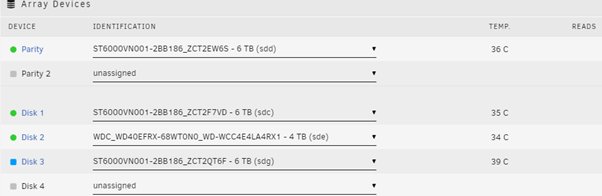

1 . What I then did was stop the array then make Disk 3 "unassigned" → restart the array then STOP again and went back to Disk 3 and reassigned it to the disk that was there.  See image
The system gave out a few error messages (which I believe are expected) and the "rebuild" started.

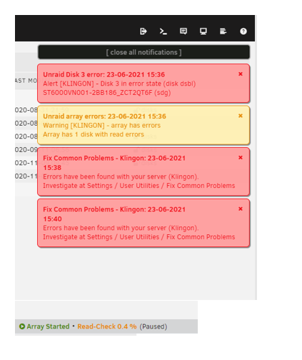

Then pretty soon a series of error messages flashed and the "rebuild" was PAUSED
I stopped the array again and then went to Disk 3 and that disk was no longer there

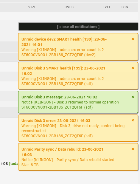

Then I turned the array off, powered down, changed the SATA port to a different one and rebooted.  Turned the array off and behold, that missing disk was back.  Reassigned it to Disk 3, turned array on and got some confirmatory messages (see below)
I took another set of diagnostics (attached).   Now the array "rebuild" restarted and so far has been running for the last 4 hours
What is going on?  Is my SATA card bad?  We can be sure that the disk is not dying right?
Really REALLY appreciate the input and help
klingon-diagnostics-20210623-1552.zip
Disk dropped offline again, this is usually a connection/power problem, if you already replaced the SATA cable replace the power cable.
Thank you for the reply.  It's "rebuilding" right now (at 49%) - I'm guessing I should wait and see, let it complete (if it does) then change the power cable?  Or interrupt the process now?
Thank you
If it finishes replace after, if it errors out again replace before another attempt.

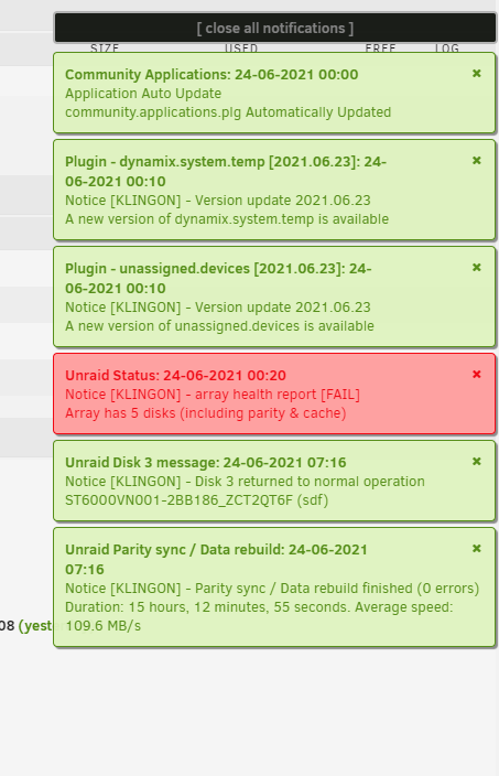

It worked !!  Many thanks for the help
