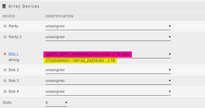

On the screenshot you can see in purple the disc device which is linked through unraid vm.
It is physical the same HDD as the expected array device what is in yellow.
Because that it is not possible to pass through a single HDD to an unraid VM I need to rebuild the array with the purple disc without loosing all the data on it.
Consider it is the same drive just with other naming convention because it is linked and not pass through.
Hope that makes it more understandable.

Tools -> New config will allow you to assign a different disk, data will be kept as long as it was using the standard Unraid partition.
nothing changed on the drive. It is just the way unraid recognize it.
Virtual Hard drive VS. Physical Hard drive.
When you mount it its same partition layout same file system and so on.
Unraid assigns drive using their ID and Serial Number. Clearly, when virtualizing the drive, the ID changed.
It is quite understandable why Unraid does not find the drive.

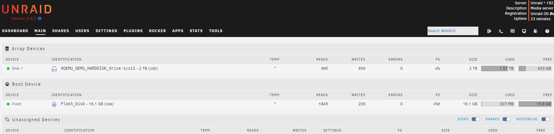

Problem solved! Just made new config 🙂
Yeah, sorry we were not clear on that. New config does not modify the data drives.
