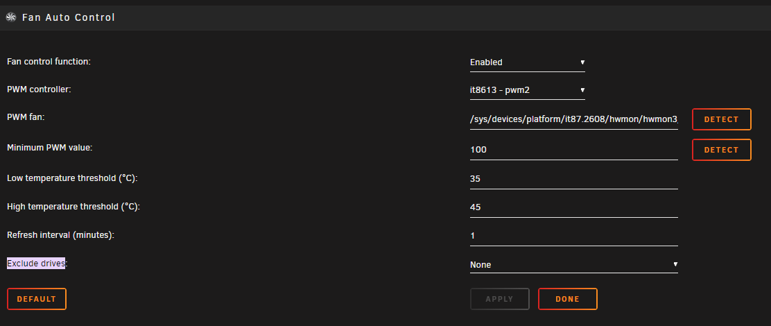

  1. can someone explain me if it is normal that the fan control always shows "Status: Stopped"

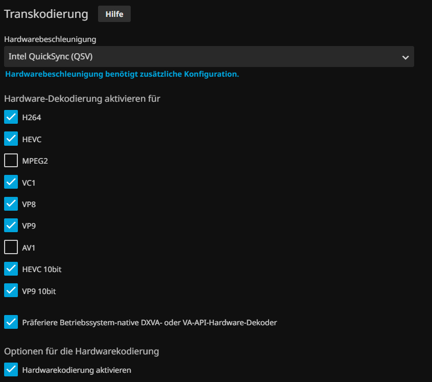

  2. Unfortunately, the same problem. Is there somewhere a log that shows me more information about the transcoding Plex is doing?

  4. Hi guy's I have geneally speaking two problems. 1. While Intel iGPU SR-IOV Plugin installed the command intel_gpu_top is not working. 2. If i try to pass through one of the virtual gpus from the plugin to my jellyfin container jellyfin will not start to hardware accelerate. added the group to the container with "--group-add={groupid}" added the device by adding "/dev/dri/renderD130:/dev/dri/renderD130" device to the container activated HA in Jellyfin and used Quicksync whichs is supported by my alder lake gpu I'm pretty much without any idea. SR-IOV is working fine on my windows 11 vm so it is generally working in unraid

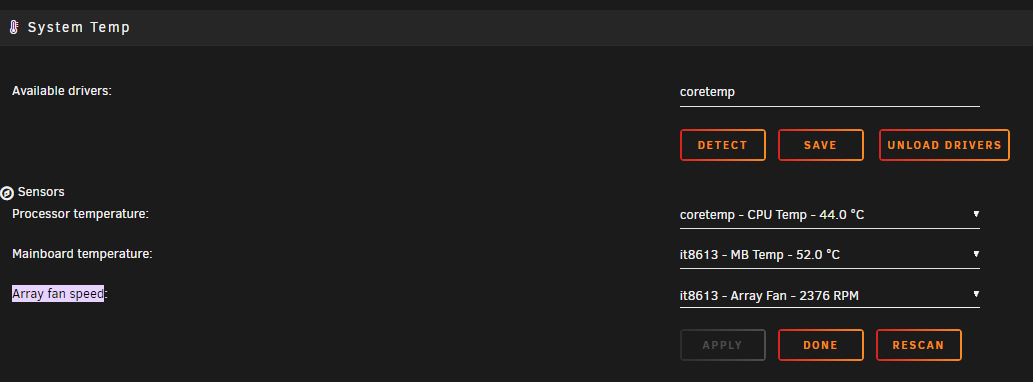

  5. Thank you for your response. With the power of AI I found a solution for me. Used pwmconfig to create a fancontrol configuration file. That is now injected with a userscript that runs on array start. #!/bin/bash cat <<EOF | sudo tee /etc/fancontrol # Configuration file generated by pwmconfig, changes will be lost INTERVAL=10 DEVPATH=hwmon1=devices/pci0000:00/0000:00:06.0/0000:01:00.0/nvme/nvme0 hwmon3=devices/platform/it87.2608 DEVNAME=hwmon1=nvme hwmon3=it8613 FCTEMPS=hwmon3/pwm2=hwmon1/temp1_input FCFANS=hwmon3/pwm2=hwmon3/fan2_input MINTEMP=hwmon3/pwm2=45 MAXTEMP=hwmon3/pwm2=65 MINSTART=hwmon3/pwm2=22 MINSTOP=hwmon3/pwm2=20 MINPWM=hwmon3/pwm2=0 MAXPWM=hwmon3/pwm2=255 EOF echo "Starting fancontrol" /usr/sbin/fancontrol & exit 0

  7. Hi Community, on my mini PC is the system fan not working in unraid. I need to set the fan speed to a fix level, but without System Temp Plugin it wouldn't work at all. What I try to archive is that the fan communicates with the thermal sensor my system is not running hot, and the fan is not running 24/7. Could someone help me with that? jericho-diagnostics-20240527-2205.zip
