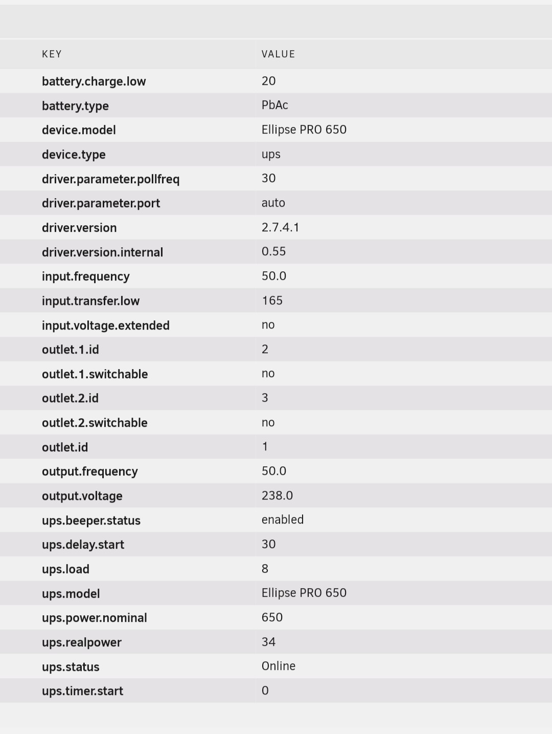

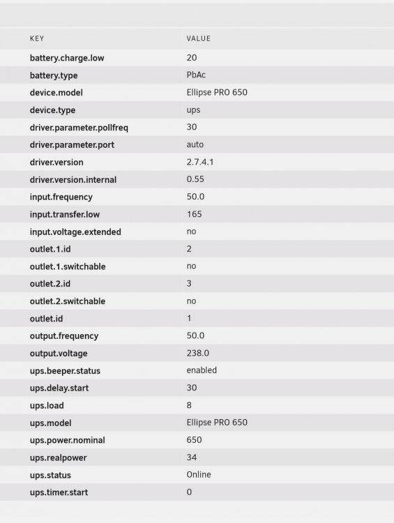

So I have just gotten an Eaton Ellipse PRO UPS 650 and installed NUT and have configured it (correctly hopefully)
I noticed in the dashboard that the nominal power reading is just showing a red 'w'. Wasn't sure if this is correct? Is it an 'on battery' reading?
I can't see any settings that might reference it
Many Thanks
Seems your UPS capacity was 650w, so input it in NUT setting, then it should calc the power usage base on "Load %" .
Ok thanks, it's 400 Watt - 650 VA. I will take a better look once I'm back home but it didn't appear that I could enter any settings.
I did see that NUT could actually see the nominal power but I guess not the wattage

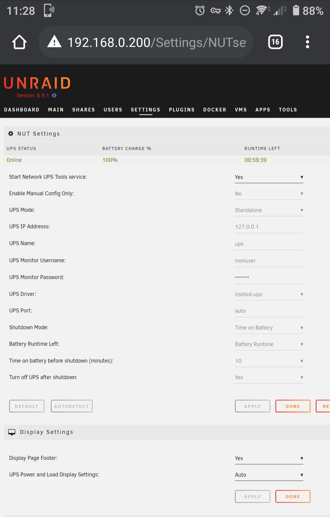

Set it to manual will fix the issue.
Thank you, that seems to have fixed it
