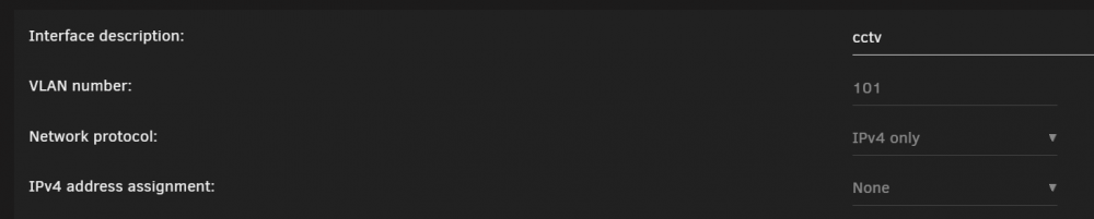

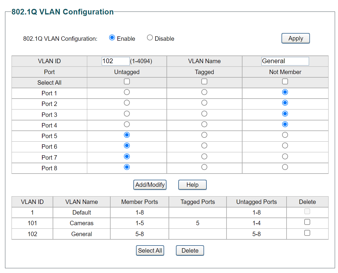

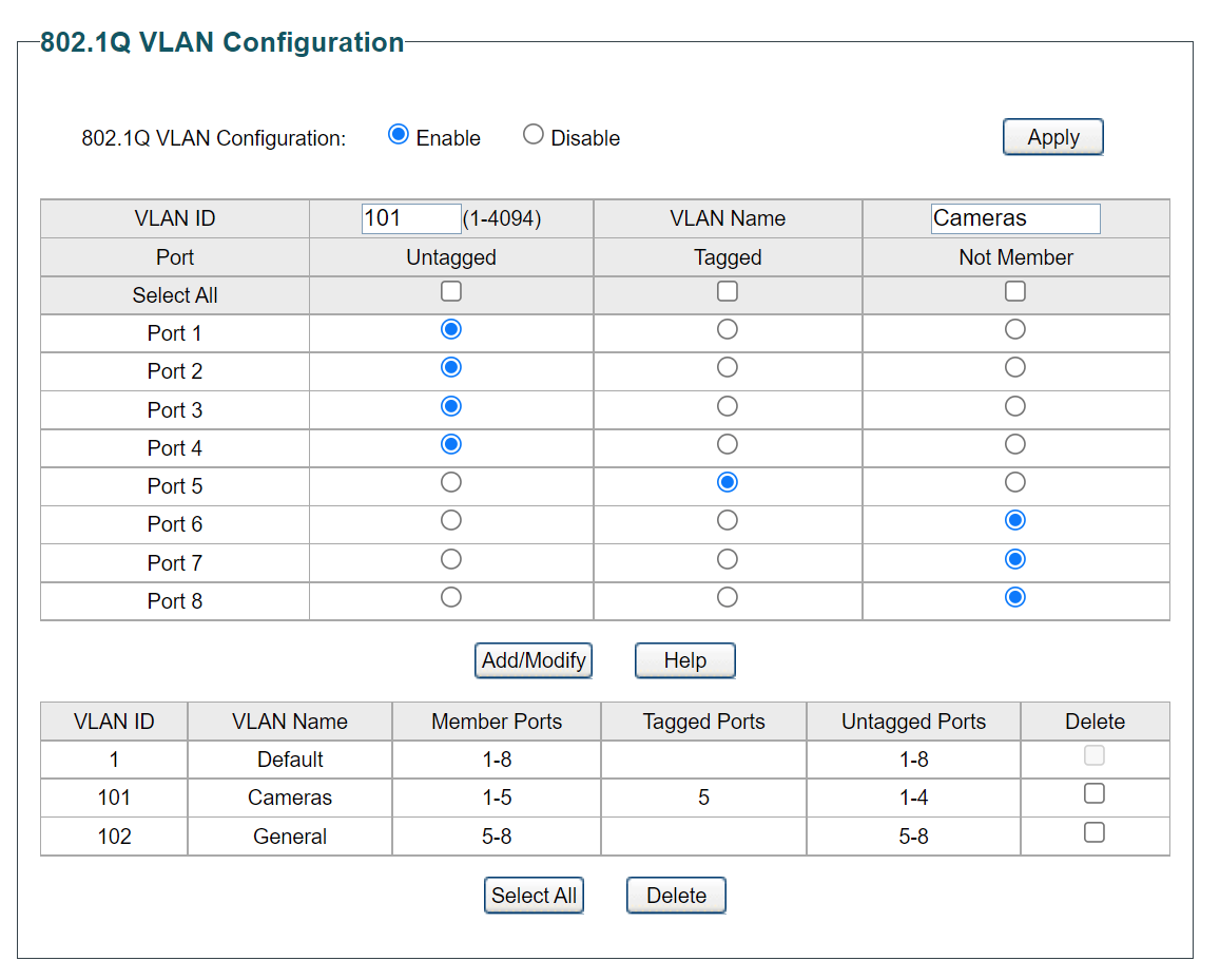

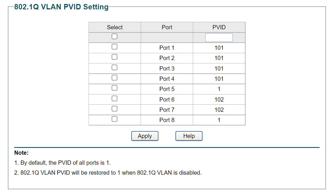

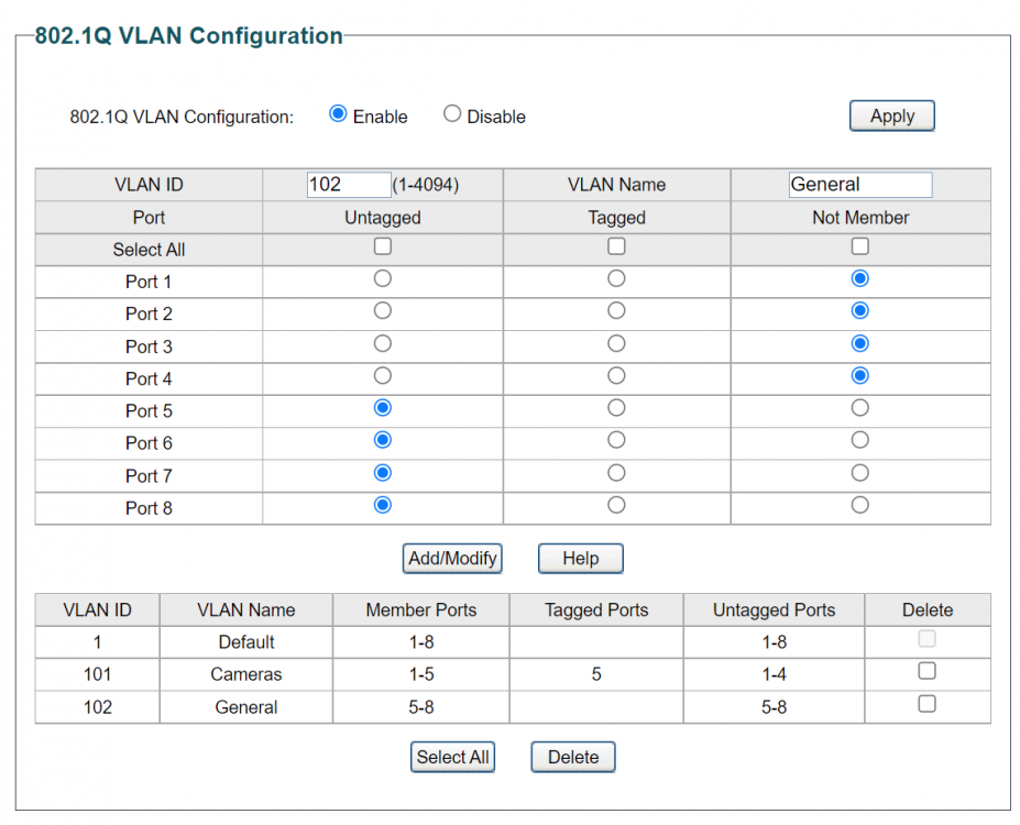

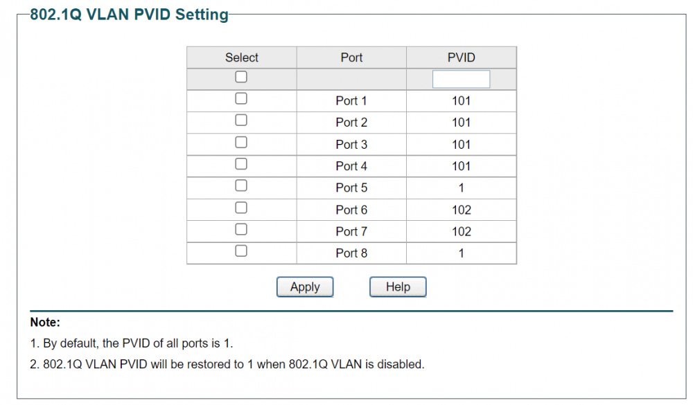

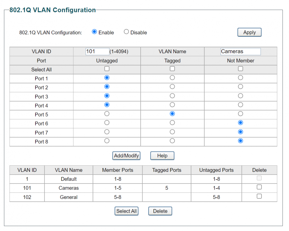

June 30, 20215 yr Author Here are the details of how I did this... The switch is a TL-SG108PE. I'm not certain I did this right. It seems to accomplish what I set out to do, but I am NOT an expert on networking by any means. Ports 1-4 on the switch are for the cameras. Port 5 is my server. Ports 6-7 are empty but will be general purpose. Port 8 connects to the rest of my network via another switch. VLAN group 101 contains the 4 camera ports untagged, as well as the server port tagged. VLAN group 102 contains the server port, the other general ports, and the larger network port untagged. Then here are the PVID settings: Then on my server, I enabled VLAN in network settings, and created 101 (apparently it was important that the number you create matches the VLAN number from the switch. I wanted the VM to be connecting to the VLAN that only includes the cameras and the server, and not the one with access to the rest of the LAN. Hence, 101 per the 1st image above. Then on the VM settings, I change the network bridge to br0.101, which I had just created. Last, in the VM, I set a static IP in Windows, which is different from the rest of my network (ie 192.168.10.X instead of 192.168.1.X). I also changed the IPs of the cameras so they would be on the same group (also 192.168.10.X). Now the VM and cameras seem to be totally isolated from the rest of the network (including the rest of the Unraid server the VM runs in), but are able to access eachother. Any comments/pointers?
July 1, 20215 yr The switch TL-SG108PE and Cameras part was straightforward, Tag it then connect thr br0.101 . 5 hours ago, stev067 said: Last, in the VM, I set a static IP in Windows, which is different from the rest of my network (ie 192.168.10.X instead of 192.168.1.X). I also changed the IPs of the cameras so they would be on the same group (also 192.168.10.X). I notice Unraid br0.101 "IPv4 address assignment" were none, but if still pingable by main network to VM, this out of my expectation. 5 hours ago, stev067 said: Now the VM and cameras seem to be totally isolated from the rest of the network (including the rest of the Unraid server the VM runs in), but are able to access eachother. Then you access VM by VNC ? ( I believe YES ) Suggest you should connect a PC to cameras port and set IP to 192.168.1.X , then try to ping Unraid's IP , Router's IP to confirm truly isolate. Edited July 1, 20215 yr by Vr2Io
July 1, 20215 yr Author 9 hours ago, Vr2Io said: The switch TL-SG108PE and Cameras part was straightforward, Tag it then connect thr br0.101 . I notice Unraid br0.101 "IPv4 address assignment" were none, but if still pingable by main network to VM, this out of my expectation. Then you access VM by VNC ? ( I believe YES ) Suggest you should connect a PC to cameras port and set IP to 192.168.1.X , then try to ping Unraid's IP , Router's IP to confirm truly isolate. Yep I am only able to access the VM by VNC currently. That might be kind of a problem, because I have no way of viewing the Blue Iris clips, except in VNC, since there is no shared drive and no internet connection. I have to learn more about what you said here: 15 hours ago, Vr2Io said: then only provide remote access from main network to VM by InterVLAN routing or loopback or something .....

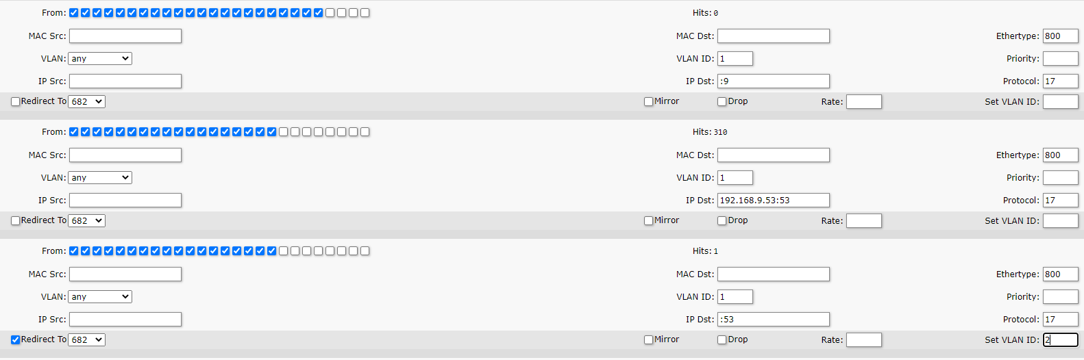

July 1, 20215 yr 21 minutes ago, stev067 said: It sounds like a lot of work to un-do all of what I just did, especially since I just bought this VLAN switch for this purpose. That's why I like ACL method, other device in network also have some kind of protect. My switch was CSS326 with 2 10G port, if 2 10G port enough, it could simply your network too. Lowest price ~ USD 130 @ Amazon. Edited July 1, 20215 yr by Vr2Io

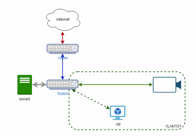

July 2, 20215 yr Ok, we need to make some stuff clear first. @stev067 you just replaced the switch connecting your Unraid server with the VLAN enabled switch, (POE not important here) so I assume your network looks like And I think your config looks good - save for using VLAN 102 as the general purpose (stick to VLAN1 unless your router and stuff need this level of control) so your goal is to limit access between the cameras and blue iris PC vs unraid and and the rest of the network. Judging from your setup, you already cannot reach the cameras and the VM from the rest of the network. and if the BR0.101 interface does not have an IP address, Unraid will also be unable to reach the VM. You seem to want to access the VM also from the rest of the network and the easiest way (not the securest) is to simply add another NIC to the VM and connect it to BR0 Alternatively if you have a router with VLAN support is simply to put the camera in their own VLAN, then program the router to deny access from the cameras to your network, and allow the VM to connect to the cameras
July 2, 20215 yr Author 10 hours ago, ken-ji said: Ok, we need to make some stuff clear first. @stev067 you just replaced the switch connecting your Unraid server with the VLAN enabled switch, (POE not important here) so I assume your network looks like And I think your config looks good - save for using VLAN 102 as the general purpose (stick to VLAN1 unless your router and stuff need this level of control) so your goal is to limit access between the cameras and blue iris PC vs unraid and and the rest of the network. Judging from your setup, you already cannot reach the cameras and the VM from the rest of the network. and if the BR0.101 interface does not have an IP address, Unraid will also be unable to reach the VM. You seem to want to access the VM also from the rest of the network and the easiest way (not the securest) is to simply add another NIC to the VM and connect it to BR0 Alternatively if you have a router with VLAN support is simply to put the camera in their own VLAN, then program the router to deny access from the cameras to your network, and allow the VM to connect to the cameras Thanks for taking a look. This networking stuff is all wizardry to me. As for the image, there is another switch between the router and this new switch, but I don't have it set up to do anything special. So the image is accurate besides that. This whole VLAN thing has been very frustrating to set up, and I've just disabled it for now. I'm having a hard time understanding the whole Tag vs Untag, vs non-member thing, and PVID settings. I'd rather not replace my router just for this, or add a second NIC. Is there any way I can manage the traffic from within the VM itself? Otherwise, is there some medium level of safety I can accomplish with what I have, while still being able to network with blue iris?

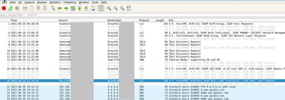

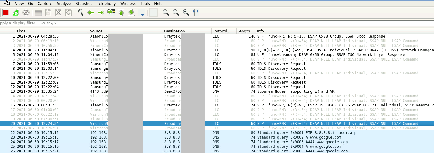

July 3, 20215 yr Author 8 hours ago, Vr2Io said: Yes In fact no recommend could provide, best should be set as tight as possible, i.e. only allow specific TCP / UDP : port passthrough to br0.101. ( So VM have greatest protection from cameras port ) You could got those info. by cameras communication protocol info. or install Wireshark to capture br0.101 traffic. I use Unifi CAM, so I will ref. below info. https://help.ui.com/hc/en-us/articles/217875218-UniFi-Video-Ports-Used Ok I used wireshark, and it looks like the only communication on br0.101 is between port 1935 of the camera IP, to another single port of the VM IP (both directions). Can I create one rule that allows communication between these 2 ports while blocking everything else on this adapter? Do I have to delete/change any of the existing rules? Maybe you have an example what this looks like in the firewall rules.
July 3, 20215 yr 5 minutes ago, stev067 said: Can I create one rule that allows communication between these 2 ports while blocking everything else on this adapter? Do I have to delete/change any of the existing rules? Maybe you have an example what this looks like in the firewall rule As said before,I seldom use software firewall, you need try how to block all and only allow one port pass on br0.101, this wouldn't log you out if any wrong due to management by br0. I think you should disable all default rules, no need delete it.
