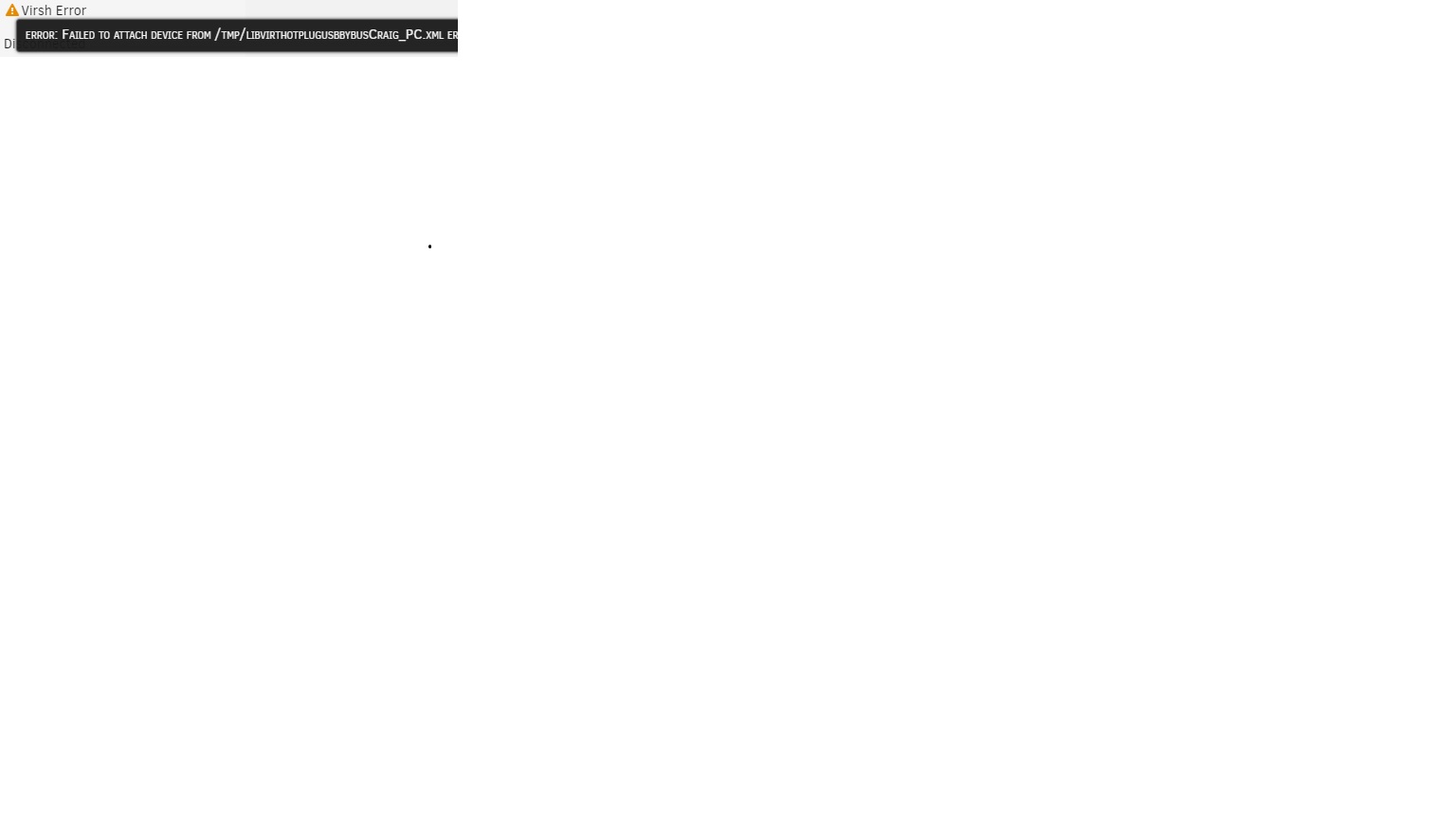

using USB manager plugin gives a Virsh Error

If you hover over the virsh error, does it say some like Document 1 invalid? Unplugging and replugging USB device may fix issue. I need to look at the setup to initialise correctly I think.
Edited by SimonF
can't see the whole error _ possible bug i need to move the screen to the right, but moveing the mouse means there is no role over, so i dont need to move anymore? using keys to move the screen means hte mouse isn't over the error and so no role over and thus no need to move the screen to the right...
however what i can read is in pic, ill try the USB change as i didn't realise the USB Setting in the VM...
There should be a syslog entry for the virsh process.
cat /var/log/syslog | grep usb_manager
