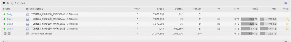

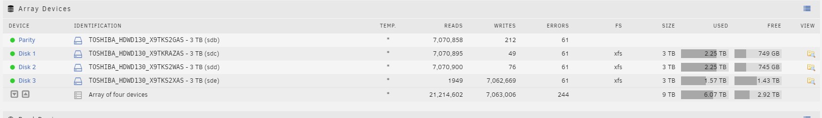

July 15, 20215 yr Hi All, I shut down my server to add a Network Card, when I booted the server back up one of the disks was missing, I suspect I dislodged the SATA cable by mistake. The disk then became disabled in the array, I shut down, reset all the cables and the disk came back up in disabled mode. I restart in maintenance mode to run smart tests - everything seemed fine - I removed it from the array and added it back in. Then rebuilt the array, no errors were reported. However, now i seems to have some XFS errors across all disks: Jul 15 10:06:12 Tower kernel: XFS (md1): metadata I/O error in "xfs_imap_to_bp+0x5c/0xa2 [xfs]" at daddr 0x11a0df168 len 32 error 5 Jul 15 10:06:12 Tower kernel: XFS (md1): metadata I/O error in "xfs_imap_to_bp+0x5c/0xa2 [xfs]" at daddr 0x11a0df168 len 32 error 5 Jul 15 10:06:12 Tower kernel: XFS (md1): metadata I/O error in "xfs_imap_to_bp+0x5c/0xa2 [xfs]" at daddr 0x11a0df168 len 32 error 5 Jul 15 10:06:12 Tower kernel: XFS (md1): metadata I/O error in "xfs_imap_to_bp+0x5c/0xa2 [xfs]" at daddr 0x11a0df168 len 32 error 5 Jul 15 10:06:12 Tower kernel: XFS (md1): metadata I/O error in "xfs_imap_to_bp+0x5c/0xa2 [xfs]" at daddr 0x11a0df168 len 32 error 5 Jul 15 10:06:12 Tower kernel: XFS (md1): metadata I/O error in "xfs_imap_to_bp+0x5c/0xa2 [xfs]" at daddr 0x11a0df168 len 32 error 5 Jul 15 10:06:12 Tower kernel: XFS (md1): metadata I/O error in "xfs_imap_to_bp+0x5c/0xa2 [xfs]" at daddr 0x11a0df168 len 32 error 5 Jul 15 10:06:12 Tower kernel: XFS (md1): metadata I/O error in "xfs_imap_to_bp+0x5c/0xa2 [xfs]" at daddr 0x11a0df168 len 32 error 5 Jul 15 10:06:12 Tower kernel: XFS (md1): metadata I/O error in "xfs_imap_to_bp+0x5c/0xa2 [xfs]" at daddr 0x11a0df168 len 32 error 5 Jul 15 10:06:12 Tower kernel: XFS (md1): metadata I/O error in "xfs_imap_to_bp+0x5c/0xa2 [xfs]" at daddr 0x11a0df168 len 32 error 5 Jul 15 10:06:12 Tower kernel: XFS (md2): metadata I/O error in "xfs_imap_to_bp+0x5c/0xa2 [xfs]" at daddr 0x697e9f18 len 32 error 5 Jul 15 10:06:12 Tower kernel: XFS (md2): metadata I/O error in "xfs_imap_to_bp+0x5c/0xa2 [xfs]" at daddr 0x697e9f18 len 32 error 5 Jul 15 10:06:12 Tower kernel: XFS (md2): metadata I/O error in "xfs_imap_to_bp+0x5c/0xa2 [xfs]" at daddr 0x697e9f18 len 32 error 5 Jul 15 10:06:12 Tower kernel: XFS (md2): metadata I/O error in "xfs_imap_to_bp+0x5c/0xa2 [xfs]" at daddr 0x653bd0d8 len 32 error 5 Jul 15 10:06:12 Tower kernel: XFS (md2): metadata I/O error in "xfs_imap_to_bp+0x5c/0xa2 [xfs]" at daddr 0x653bd0d8 len 32 error 5 Jul 15 10:06:12 Tower kernel: XFS (md2): metadata I/O error in "xfs_imap_to_bp+0x5c/0xa2 [xfs]" at daddr 0x653bd0d8 len 32 error 5 Jul 15 10:06:12 Tower kernel: XFS (md2): metadata I/O error in "xfs_imap_to_bp+0x5c/0xa2 [xfs]" at daddr 0x653bd0d8 len 32 error 5 Jul 15 10:06:13 Tower dhcpcd[3442]: br1: using IPv4LL address 169.254.222.50 All drives appear to have errors now, i've attached the diagnostic files from before and after Jul 14 - While disk was disabled. Jul 15 - After array was rebuilt Any advice on what I should do here? Thanks! tower-diagnostics-20210715-1011.zip tower-diagnostics-20210714-1730.zip

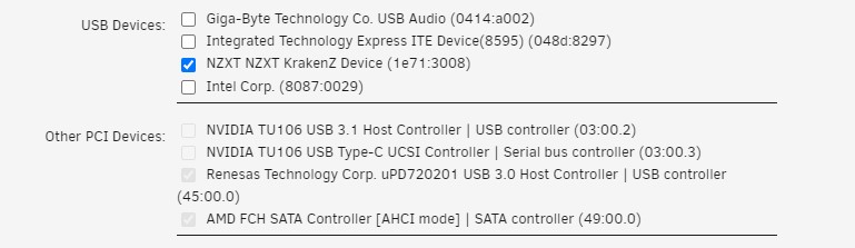

July 15, 20215 yr Community Expert This SATA controller is being passed through to the Win10 VM: 49:00.0 SATA controller [0106]: Advanced Micro Devices, Inc. [AMD] FCH SATA Controller [AHCI mode] [1022:7901] (rev 51) DeviceName: X570/590 SATA1 Subsystem: Advanced Micro Devices, Inc. [AMD] FCH SATA Controller [AHCI mode] [1022:7901] Kernel driver in use: vfio-pci Kernel modules: ahci So when the VM starts Unraid loses access to it and all the connected disks.
July 15, 20215 yr Author OMG! Have i seriously just been this stupid!🙄 This is next level dumb ! I moved my USB PCI card updated VM must have check the SATA controller too somehow. I shall remove that and hopefully my problems will go away
July 15, 20215 yr Author 46 minutes ago, JorgeB said: This SATA controller is being passed through to the Win10 VM: 49:00.0 SATA controller [0106]: Advanced Micro Devices, Inc. [AMD] FCH SATA Controller [AHCI mode] [1022:7901] (rev 51) DeviceName: X570/590 SATA1 Subsystem: Advanced Micro Devices, Inc. [AMD] FCH SATA Controller [AHCI mode] [1022:7901] Kernel driver in use: vfio-pci Kernel modules: ahci So when the VM starts Unraid loses access to it and all the connected disks. Hi JorgeB, thank you so much for taking the time to review my logs i really appreicate it. This is 100% a classic case of dumb user error! I can confirm its all working well now, once i gave the sata contoller and the disks back to unraid..... thank you again!
