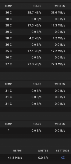

July 16, 20215 yr Hi guys, I experience - for my unknowing logic - a weird copy behavior when writing data to the array (e.g. from USB HDD): It all starts as expected, all disks except the 2 writing ones (Parity and the disk the data is landing on) read with 223-250 MB/s and the writing ones write with the same speed, but after a file or so most disks stop reading and the parity and mostly 2, sometimes 3 other disks continue reading/writing like using read/modify/write...but simultainiously on multiple data disks. It looks like this: I tried it with rsync and Midnight Commander, with dockers on and off, always the same result. From time to time the copy process seems to get back on track copying as expected, but again shows this behavior shortly after. Also the whole system becomes "weird", like stopping/restarting dockers takes forever or doesn't even work at all or the GUI not showing they are stopped, accessing dockers websites is horribly slow (although they are on the Cache drives) and so on. I would think it's some temporary caching to RAM stuff, but I have no real idea how to find a way around it (without possibly breaking my unRAID setup 🙂 ). I tried rsync --drop-cache and tried googleing for "linux" and "unraid disable copy cache" - which in the unRAID case brings up stuff about the cache drives...it's like googleing for "big hammer". So do you have an idea what's going on and how to solve it/get around it? I wanted to copy ~10TB and after leaving it running for about 8h MC tells me it'll take another 31h to finish... Edited July 16, 20215 yr by Torben
July 16, 20215 yr Community Expert This happens if allocation mode is set to most free, writes will overlap to multiple disks and when this happens Unraid disables turbo write, most free should never be used for best performance, use fill up or highwater.
July 16, 20215 yr Author Thank you for the fast reply. I'm running all shares in High-Water mode, but investigating in this direction maybe this information could be relevant: 90% of the copy process is replacing existing files (mostly because of changed dates), only 10% is creating new ones.
July 16, 20215 yr Community Expert Yes, anytime you write to multiple disks you'll experience that, firstly because writes to parity will overlap, secondly because, and against what we asked, LT auto-disables turbo write when writes to multiple disks are detected, and nothing we can do about it.
July 16, 20215 yr Author Ok, I got that, thank you for explaining. 🙂 The point I don't really get is why it's writing to multiple disks at once (and if it's possible to work around that). I'm not starting multiple copy processes, I'm just marking all files and hit "Copy" (with one share as target), so something must "make it" multiple. I could guess, but with my 1h Google knowledge about Linux copy processes this probably wouldn't be helpful. 🙂
