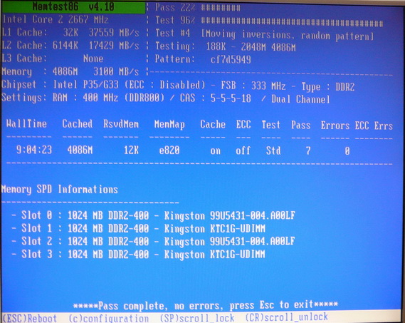

If you were asking that nicely, your wish is my command :)
Please see attached. No error during an overnight memtest.
