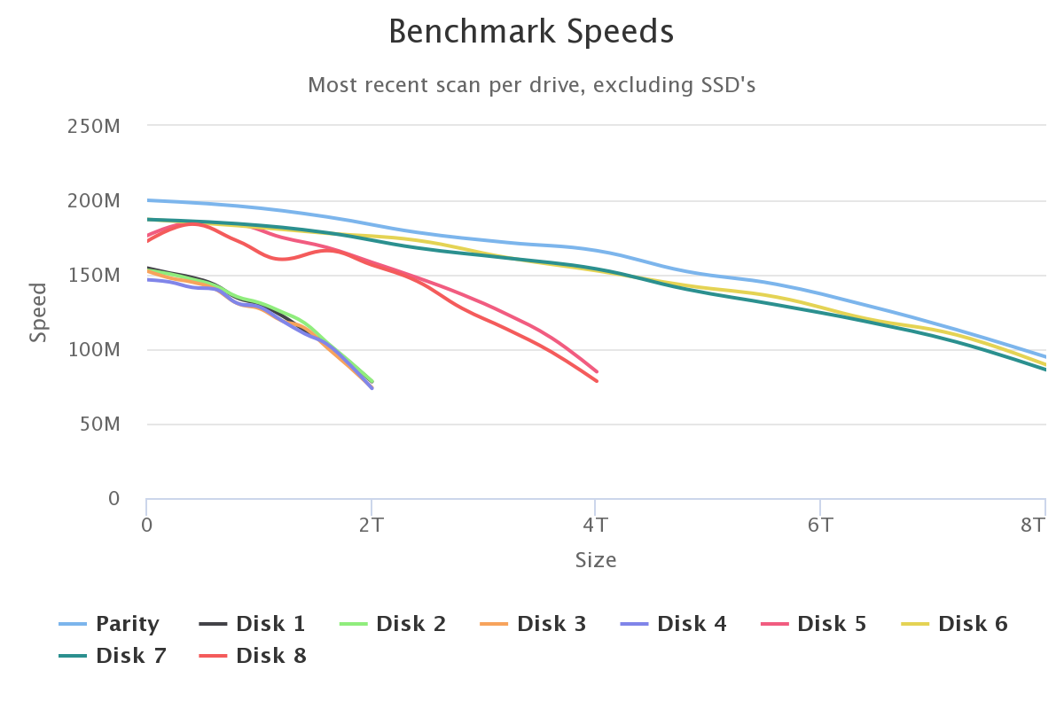

July 22, 20215 yr Author Yeah I swapped out the cache drive already. I realized that was causing some issues with dockers also. No sure what could possibily decrease the speed by 1/3. I used disk speed to check for issues and it seems like the sas 2tb drives are much much slower than the other drives maybe this could cause the issue. But I had these drives in the previous setup also.
July 22, 20215 yr Community Expert 3 minutes ago, thezyth said: and it seems like the sas 2tb drives are much much slower than the other drives 20MB/s slow or just slower? Parity check can't go faster than the slowest disk at any point.
July 22, 20215 yr Author The slowest drive is at 73 mb/s. So disk 1-4 are my slowest drives and they were also used in my previous build but I was getting much better parity check speeds. Maybe it's due to the change in the interface for the drives?

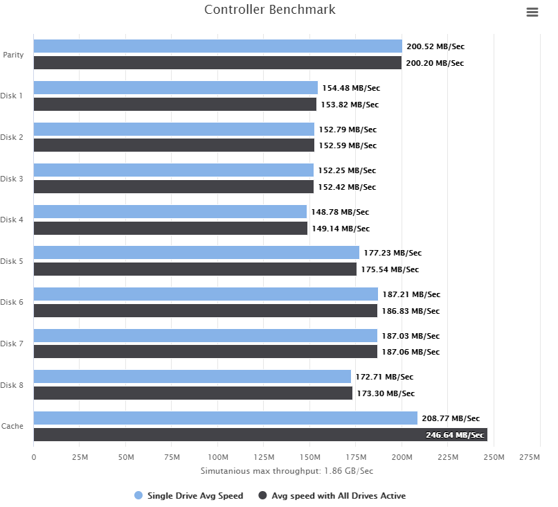

July 24, 20215 yr Author Ran a controller bench mark and I don't see anything out of the ordinary here either. Anyone have any suggestions to what else I could check?
July 24, 20215 yr Community Expert That all looks good, though it could still be a controller issue that manifests itself only during a parity check, I have no experience with that controller, do you have another one you could test with, like an LSI HBA?

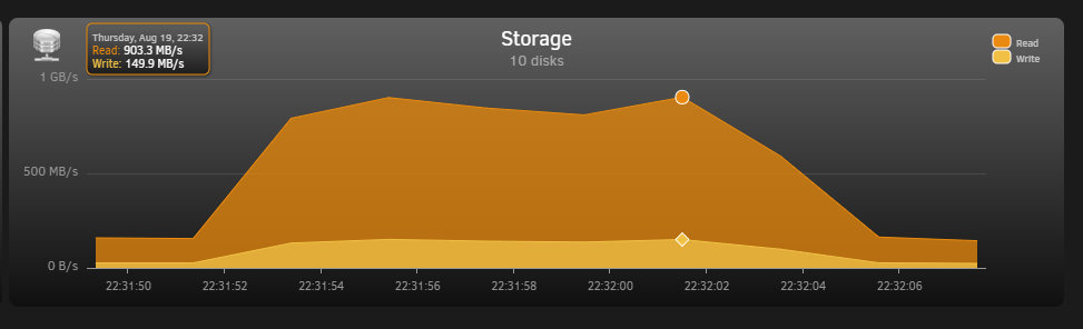

August 20, 20215 yr Author 22 hours ago, JorgeB said: That suggests it's not the controller. The speeds seem to increase for a few seconds and tapper of...is this normal behaviour?
August 20, 20215 yr Community Expert 5 hours ago, thezyth said: I do have one SMR drive within the array. Could this be the cause of the slow downs? Possibly. 1 hour ago, thezyth said: The speeds seem to increase for a few seconds and tapper of...is this normal behaviour? No, but also doesn't look like a controller related issue.
