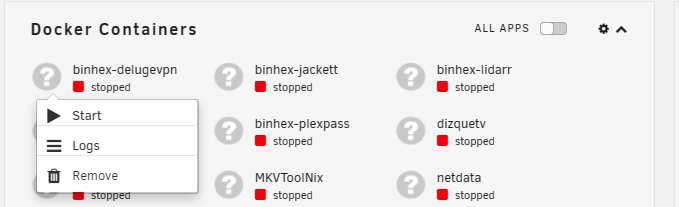

Ok, new problem. Once I got everything booted up, my old dockers were picked up and my VM, but the dockers appear to be in a weird state not they are not really installed.:

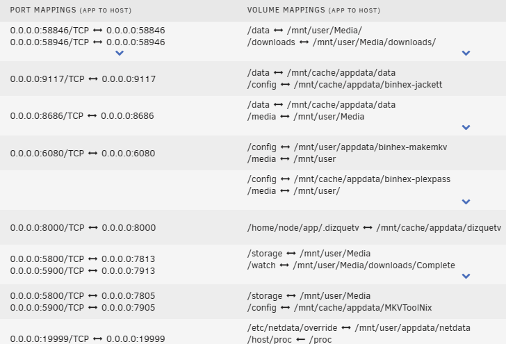

The volume mappings are right, but that's it. I can't edit anything unless I go to the Apps and try doing an installation from there, but then all the defaults are reset so I canceled out:

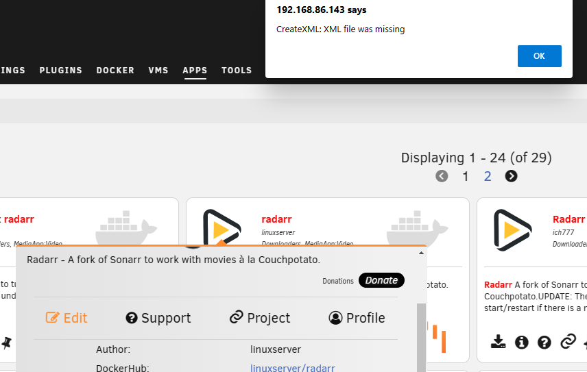

When I click "Edit" from the Apps, it says the XML is missing. I am guessing this XML was stored on the flash drive? What was the location of the XML files so I can check my backups to see if I can pull just those?
Ok I realized my docker vdisk was pointing at user instead of cache, however when I update the location to cache, all of my dockers disappear?
I suspect that the files are actually on an another drive.    Note that the /mnt/cache/appdata location is part of the ‘appdata’ share which can be referenced by /mnt/user/appdata, but this latter version also includes any ‘appdata’ folders on the main array drives.
